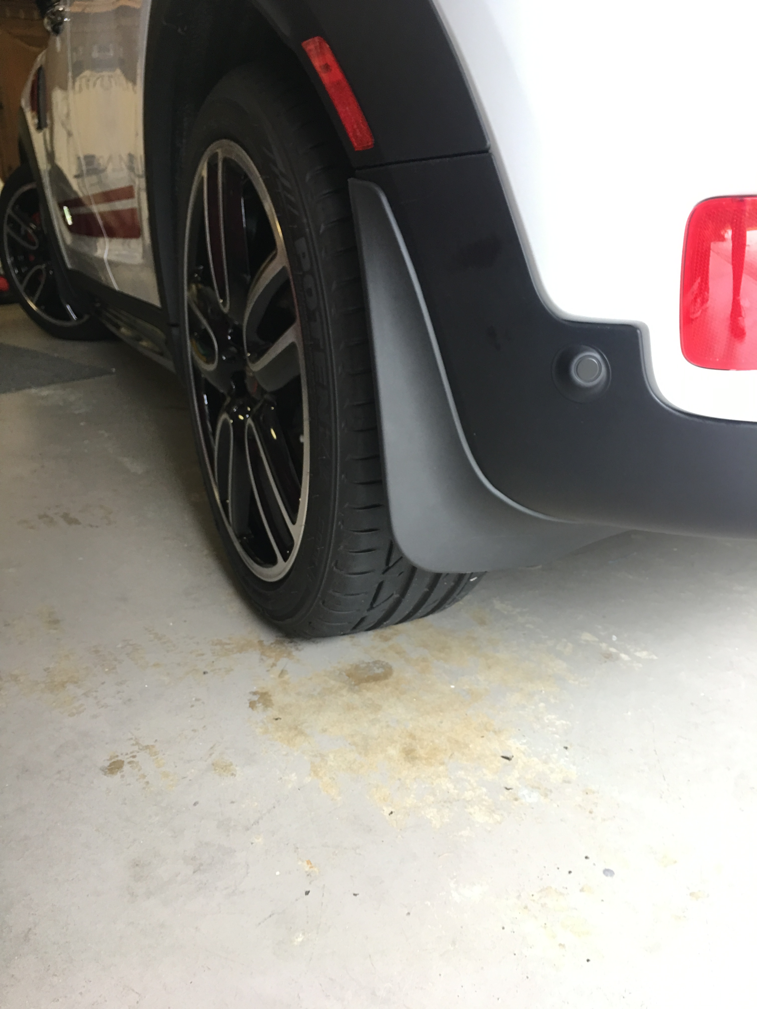

After putting some miles on our CM in all kinds of weather and road conditions, I quickly realized that flaps are would definitely help keep the flanks cleaner. So about two weeks after ordering from China, received a set of these $49 OEM knockoffs ($13 of that was shipping). They are very well made and flexible; I was pleasantly surprised! Because I didn't want to mess with the BMW plastic rivets or getting the plastic rivet tool, I ditched most of the hardware kit that came with it and instead used 3M acrylic molding tape to securely mount the flaps. Easy and secure install as long as you properly clean and prep the tape surfaces with rubbing alcohol and (optional) hexane activator. Very happy with these flaps.

A rivet tool is what you need. Check Harbor Freight or you might already have one? Bring the rivet with you to confirm that the tool die fits the pin diameter of the BMW rivet. Or use 3M molding tape as I did.
God the flaps from China. Going to install today.
Can you detail how you installed the flaps with the 3M acrylic molding tape? You said ditched most of the hardware, what did you end up using? What's the "hexane activator"?
Thanks!
Old Jun 20, 2018 | 06:20 AM
Crossingover's Avatar
Crossingover
Joined: Mar 2018
Posts: 93
Likes: 14
The hexane activator is a chemical used to prep the adhesive mating surfaces for a strong bond. I bought a pack of 5 pads for my install. Not absolutely necessary but I wanted the most secure bond. The activator popped up automatically when I was putting the 3M tape in my Amazon cart.
The only hardware I used were the metal clips for the front flaps and maybe two screws for the rears. Dry mount the flaps and note where the mating surfaces are with the wheel well trim. Then apply the activator to the flap mating surfaces and apply the 3M tape. Do not remove the liner from the exposed tape until you ready to install. Do this prep work for the other three flaps.
Clean the wheel heel well trim surfaces. When you’re ready, remove a short section of the tape liner from one flap and apply the hexane activator to the wheel well trim mating surfaces. Working carefully, attach the flap to the trim, pulling the liner tape off as you work your way up the wheel well. On the fronts, fold the little flap over and behind the trim and secure with the metal U-clip.
If you work carefully, this is an easy install that doesn’t require replacing plastic rivets. The adhesive is unforgiving so be double sure before you apply.

I got a set from China (Alibaba) for $45 for front and rear
https://www.aliexpress.com/snapshot/...Id=32847643983
The rear flaps installed using the OEM holes. The front flaps used the lower OEM hole and a clip for the top. I added a screw about halfway up.
The OEM clips can be reused. Insert a small diameter tool to push the pin through and out. The clip will release. I used an ink pen tube (clipped) as a new pin to re-attached the OEM clip.

The re is one screw on the bottom of each rear wheel well trim that I removed and replaced after installing each mudflap. No need to remove wheel. Yes, the dark U-clips that attach over the folding flap on each front mid flap.

Yeah, no metal.
And in case you didn't know...I didn't know...the plastic rivets that are there already are easily removed after you push the center pin all the way through until if falls out. Couldn't be simpler.
