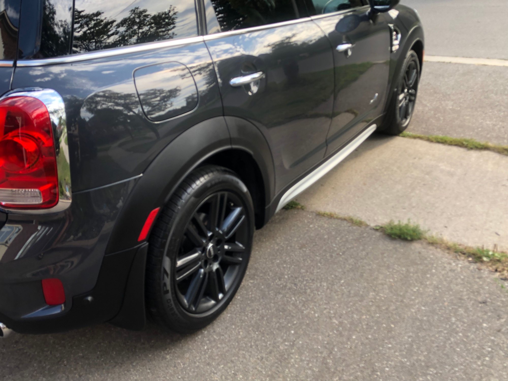

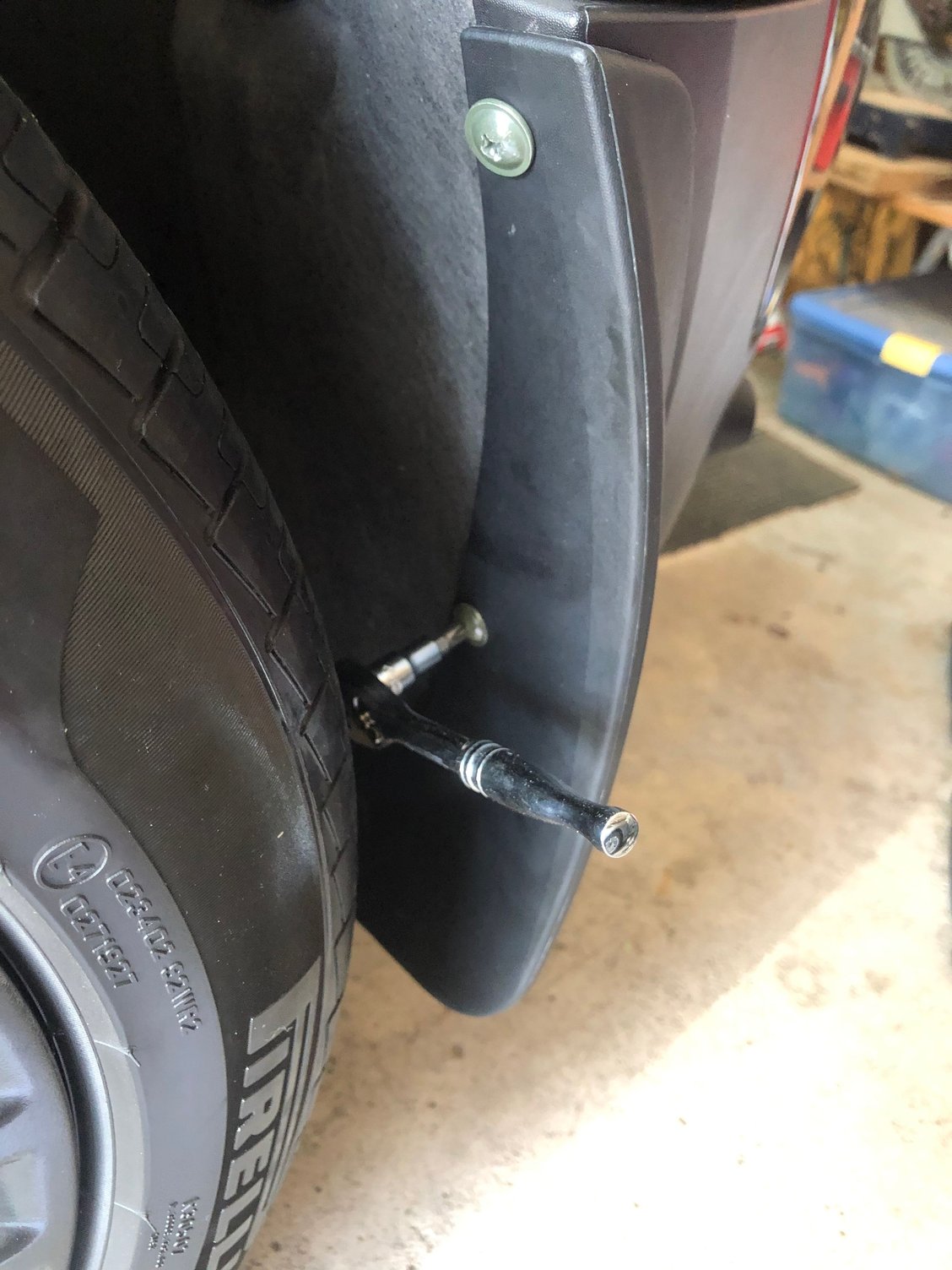

Shipping to Canada took about 3 weeks. Quality is excellent and the fit is perfect. Unlike others who have talked about installing with tapes and adhesives, I used the included hardware. I doubt that Canadian winters would allow for anything other than screws and bolts to attach mud flaps.
I was able to complete the entire job with a few simple tools (hammer, pliers, flat and star head screwdrivers and a 5/16 ratchet and socket). I did not need to remove wheels or to jack car up. You should be able to manage this job if you’re willing to lie on the garage floor and get a little dirty. Have attached a few pics as the mud flap set does not come with instructions. All holes fit to what was already filled with a plastic blind rivet on the Countryman wheelwell. I did drill one extra screw (provided in kit) into the wheelwell trim on both front flaps. Flaps attach solidly and without gaps.
Not a bad little project for a Sunday afternoon - all in all took about an hour.
Underside of front wheel well; remove screw and save for installation of new front flap
Front flap; reuse blind rivet if possible; included black clip to fold plastic tab over behind the wheel trim and fasten by pushing on the black metal clip; drill in additional screws if desired for tighter fit
Front mud flap installed
Rear flaps- remove the two plastic blind rivets and slide metal washer over body trim, then fit flap and drill in the two new screws (included) - not shown - remove bolt from underside of wheelwell with 5/16 socket and reinstall through the mud flap through provided perfectly matched hole.
Side view of completed flap installation- I’d say they are a perfect match and fitment!
Rear flap installed
Front flap installed
