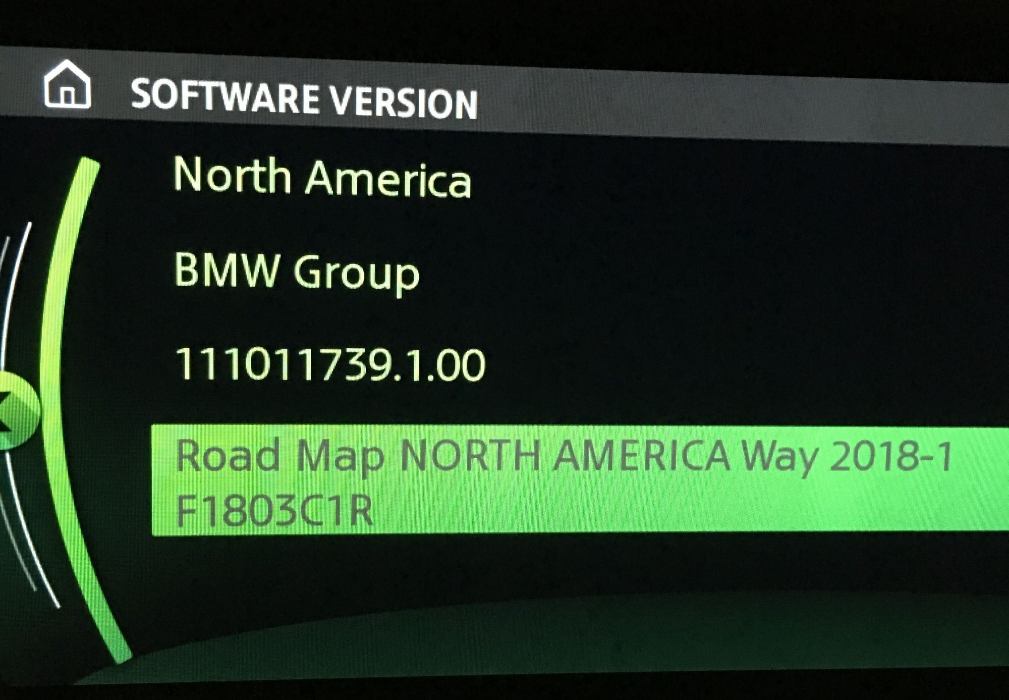

Mine has Road Map NORTH AMERICA WAY 2018-1, and I can't find anything Road Map NORTH AMERICA WAY 2018-3 related on Google...

I'm unfamiliar with the WAY map. Perhaps it's updated hardware that has enhanced maps or changes related to the MINI connected services. I assume you have a 2019 model since you just got it. Searching google, I see references to 2018-1, but nothing newer for North America or Europe. So it appears that 2018-1 may be the latest for that map.
I updated my EVO map (free from google search, UK based website) to 2018-03. I noticed that the Boston MassPike (I-90) changes due to electronic tolling have finally been updated. It shows each of the e-tolls on the map and the new ramp locations near the Weston Tolls (I-90 & I-95 intersection).
