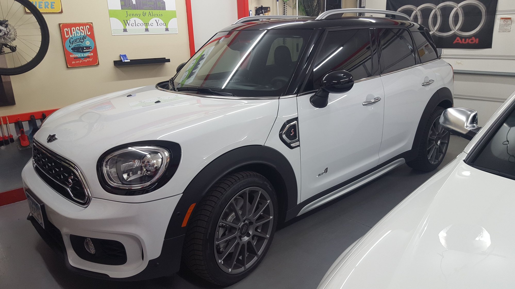

Old Nov 25, 2017 | 06:49 AM
MrFunk's Avatar
MrFunk
Joined: Mar 2016
Posts: 437
Likes: 54
From: Upper Midwest
Ok so it was much easier than I thought. Front popped out easily then clipped back in even easier. Rears were a bit more work (not really) to get out - I used a trim removal tool... getting the new ones on was a tad bit more involved than the rears (not really). All in took 15 minutes.
Thanks all for the pointers.
Looks WAAAAY better.
