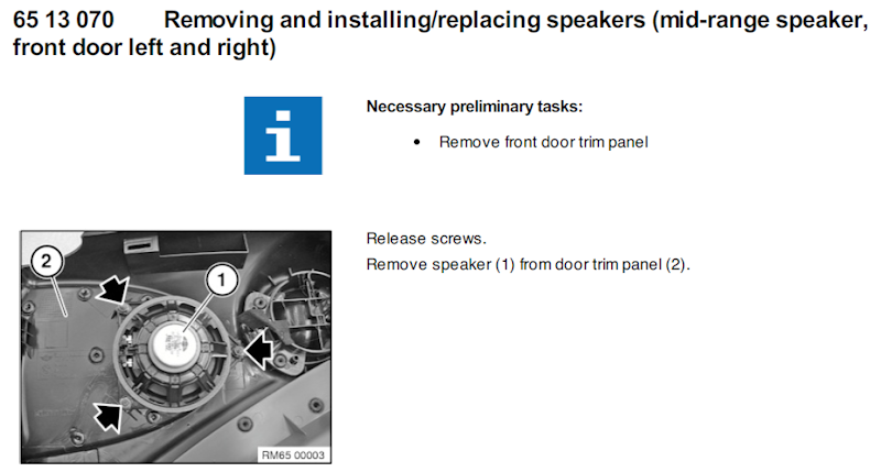

I have a Service Manual that shows how to remove the door card (trim panel) and it appears that the speaker is on the door card and not in the metal part of the door and hence not needing to have the vapour barrier touched.
I was going to do this myself but the handle recess was not budging. Not wanting to break anything I figured this would take an experienced technician 1/2 hour - 1 hour tops and I was willing to pay that. I left their establishment and went to an independent car stereo and tint place near to my house and they quoted $45 to put my speaker in. AAMOF, they could tint the car and install the speaker for $100 less than this place was quoting me.

I had another look at the service manual in a different area and saw this:
Maybe that is why the recess was not coming off. I did not remove the little cover and hence did not remove the screw underneath ...

Sounds like you found the reason.

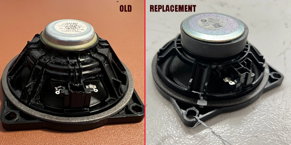

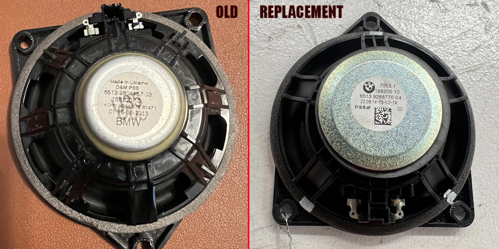

The speaker installation is complete. I went to the tint / stereo shop, and they installed it for me - said it would take 1/2 hour and it was slightly over 1 hour before they told me it was done, so no idea if it took the full hour. The owner of the shop suggested that it was not as straightforward as (for example) my GMC truck which was the last vehicle I pulled the panels off. Mentioned broken clips etc. Bottom line is that it was switched and the door panel is back on and looks and feels just as before with no rattles or noises. 🤞
Now that I have the old speaker out, I can see that it was a 4 ohm speaker and the one from eBay has no such indication, nor could I find any specs online for its part number. Anyway, it sounds fine and balanced to me. Looking at the pictures, it is clear that the newer speaker is a better and more robust speaker than the one removed. I say that for me it was $45 well spent to have the experts do this.
