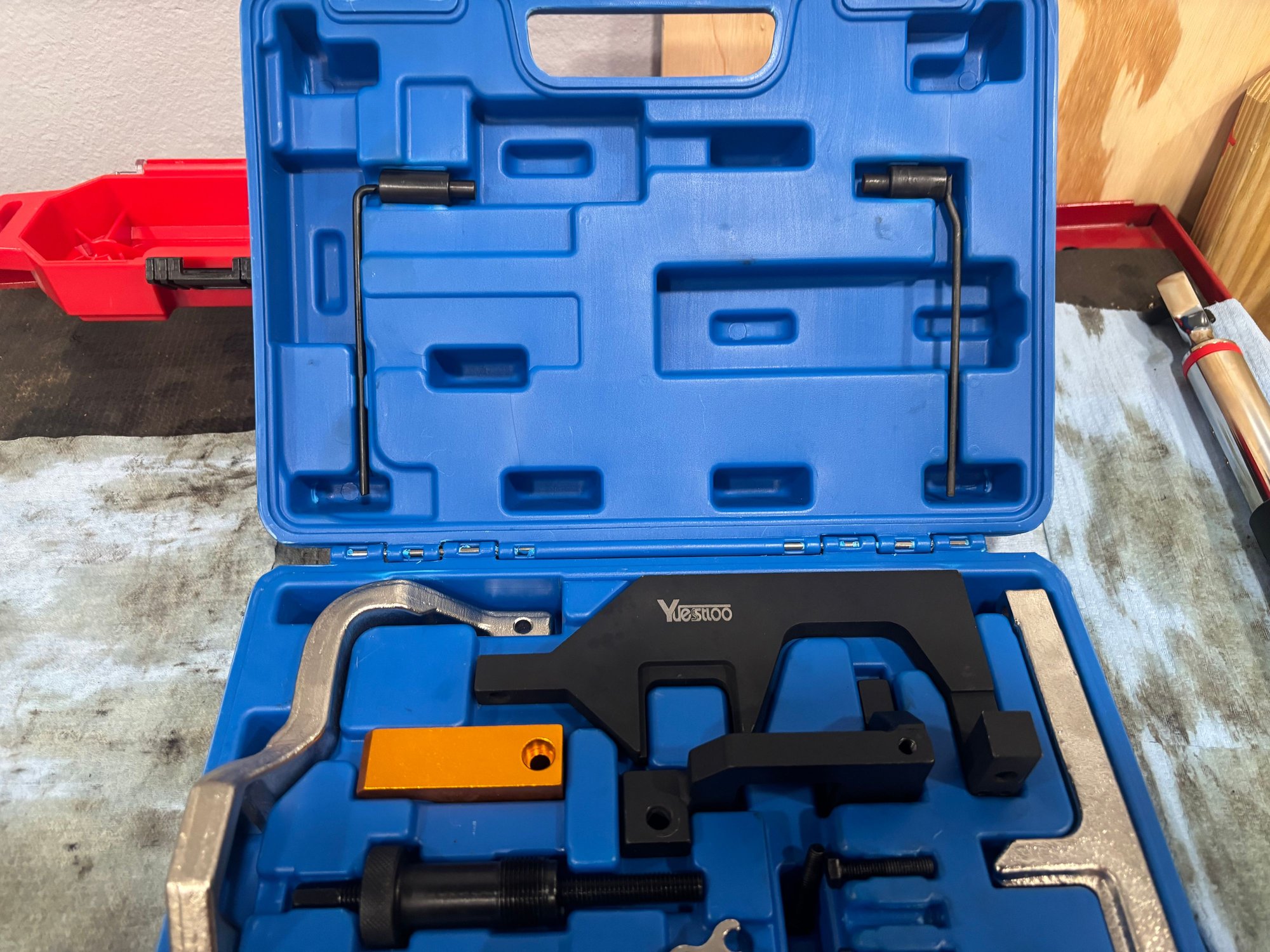

The picture is the tool I used that is for keeping timing, basically you put a one of the pins on top in the flywheel and the black brackets go o to cam.

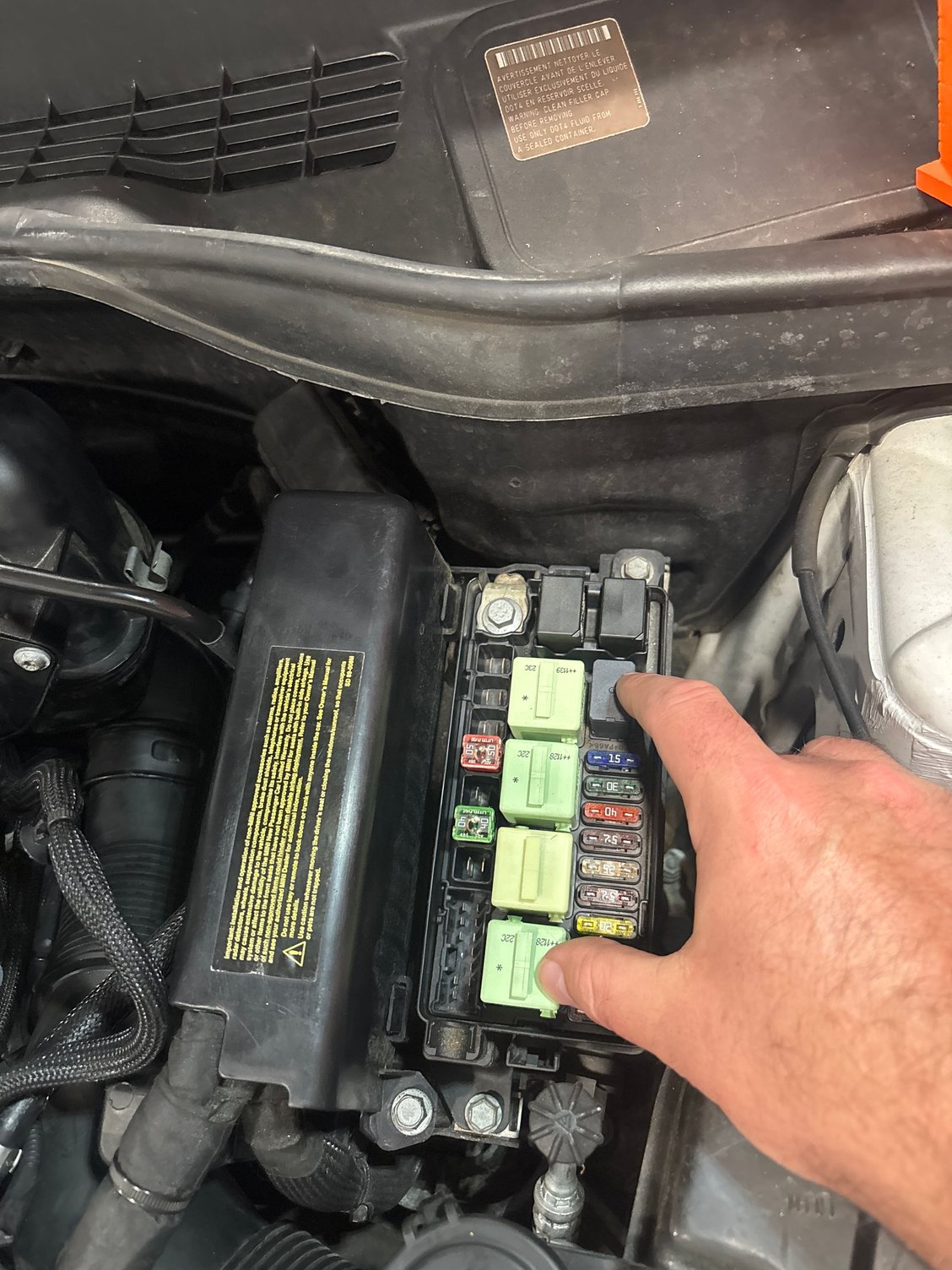

So I changed both the r1 & r6 relays still nothing. Battery was reading 51% so I'm going to charge it over night and see if that makes a difference.. Thumb and finger on relays I replaced.

If I recall it was that very top yellow/green one in the middle that was my problem. I could have the car on and in run mode and then go outside and fiddle with in and hear other noises go on/off. Seems like something is not allowing spark. Perhaps not enough fuel pressure to trigger the spark? Computer is not seeing some parameter to allow the fuel to inject or spark it seems. Definitely charge the battery and maybe load test it.
