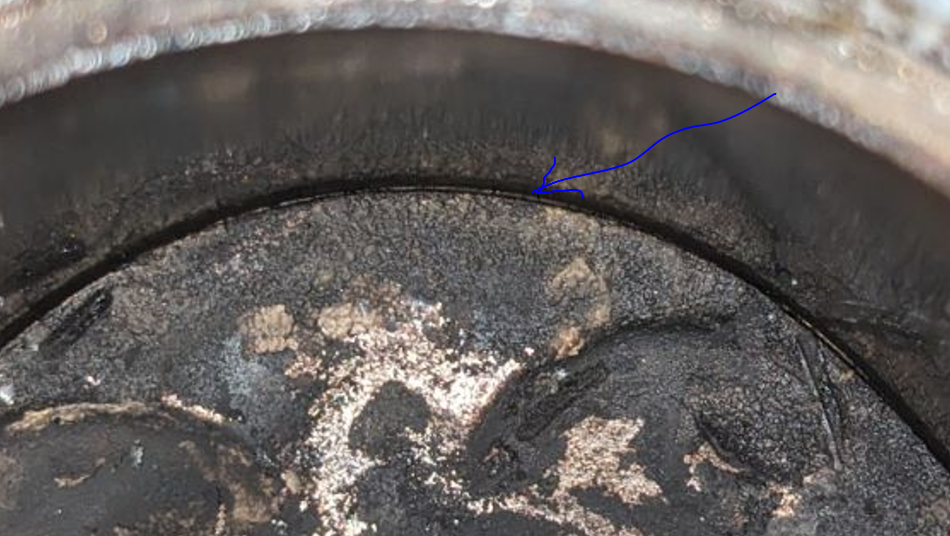

I just noticed something odd though, I can rock the pistons by finger. In the below image, it's maybe hard to see so I've put an arrow. That shiny thing right where the piston and wall meet, you can SEE the top piston ring. That seeming alarming to me, I pushed the piston, and it wiggles. All of the pistons can be pushed and move.
I've rebuilt a chevy 350 and a Jeep straight six...both of those engines had piston clearance of a just a couple of thousandths of an inch, you could absolutely not see the rings or visibly wiggle the pistons.
Maybe just how these engines are?? Compression good, ran ok except that single cylinder misfiring constantly.

My first impression is that's discolored from rust from the piston remaining stationary for a while. But I think it would require more than a few days. And I would expect to see it in other cylinders, too.
That you can wiggle the pistons suggests a good amount of cylinder wear. The persistent misfires can be tied to wear.
Can't eliminate ring problems but you'll have to remove the piston and check the rings. Also, while you are there check piston ring land wear, piston wear and cylinder wear up and down the cylinder.

Thanks RockC. Sure wish I didn't have to go that far but I guess you're probably right. Have to pull the engine out the rest of the way... lucky me.
This is from the now-paid TIS site. Don't know if it is the right measurement.
Piston running clearance, translates to .0012" - .0026" of clearance between piston and cylinder wall, again, if TIS is telling me what I'm looking for. I don't think I could move the piston like that if it was within spec. U.S. toolmaker, I think in inches, sorry.

OH, and I should mention, I discussed pistons rocking in the bores up above. Apparently that's not all that abnormal. Lots of youtube videos talking about it. The head of the piston expands a lot more than the skirt during engine operation, the heat of combustion against it. Piston rock isn't an indicator of anything necessarily. The piston has to be removed and micrometered to know if it is a problem. Which in itself is a problem. Above I posted the piston measurements, spec says to measure pistons at "point A" but I have never found where point A is. Most manufacturers designate a spot on the skirt for micrometer measurement. I went 10mm blow the oil control ring and my pistons measured within the above spec. Can't know if it's right, but it's the best guess I have, that they are still ok.
