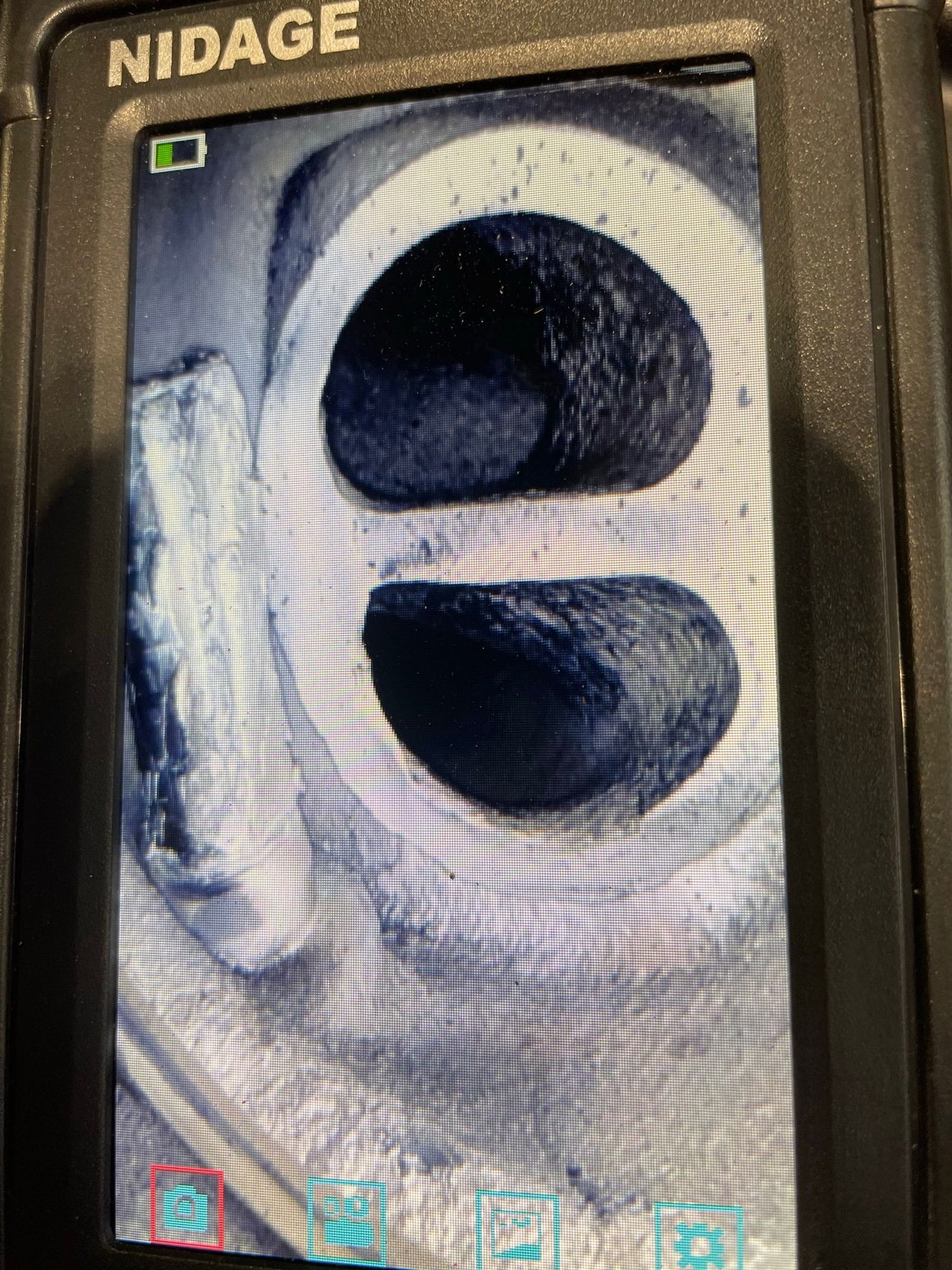

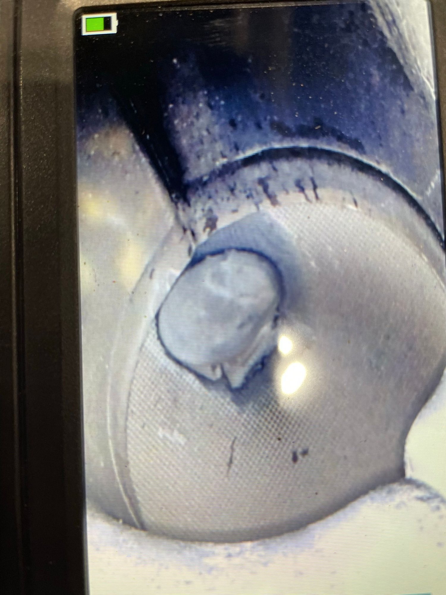

Well, I found out why my car isn't building any boost pressure. I pulled the O2 sensor and used a borescope to check the wastegate. Turns out the wastegate is totally gone. I suspect that it is somewhere down in the cat. I will have to find it when I pull the turbo.
Where did the wastegate go?

From: WNY
Wow!
If that is the actuator rod on the left side in the picture, it looks pretty beat up. Curious what took place in there!

That is the actuator rod. It almost looked melted but I am not sure. The wastegate actuator does move the rod with 15" vacuum but it was binding. That is why I used the borescope. There is no play at all in the wastegate mechanism.
Has anyone experienced the wastegate breaking off?

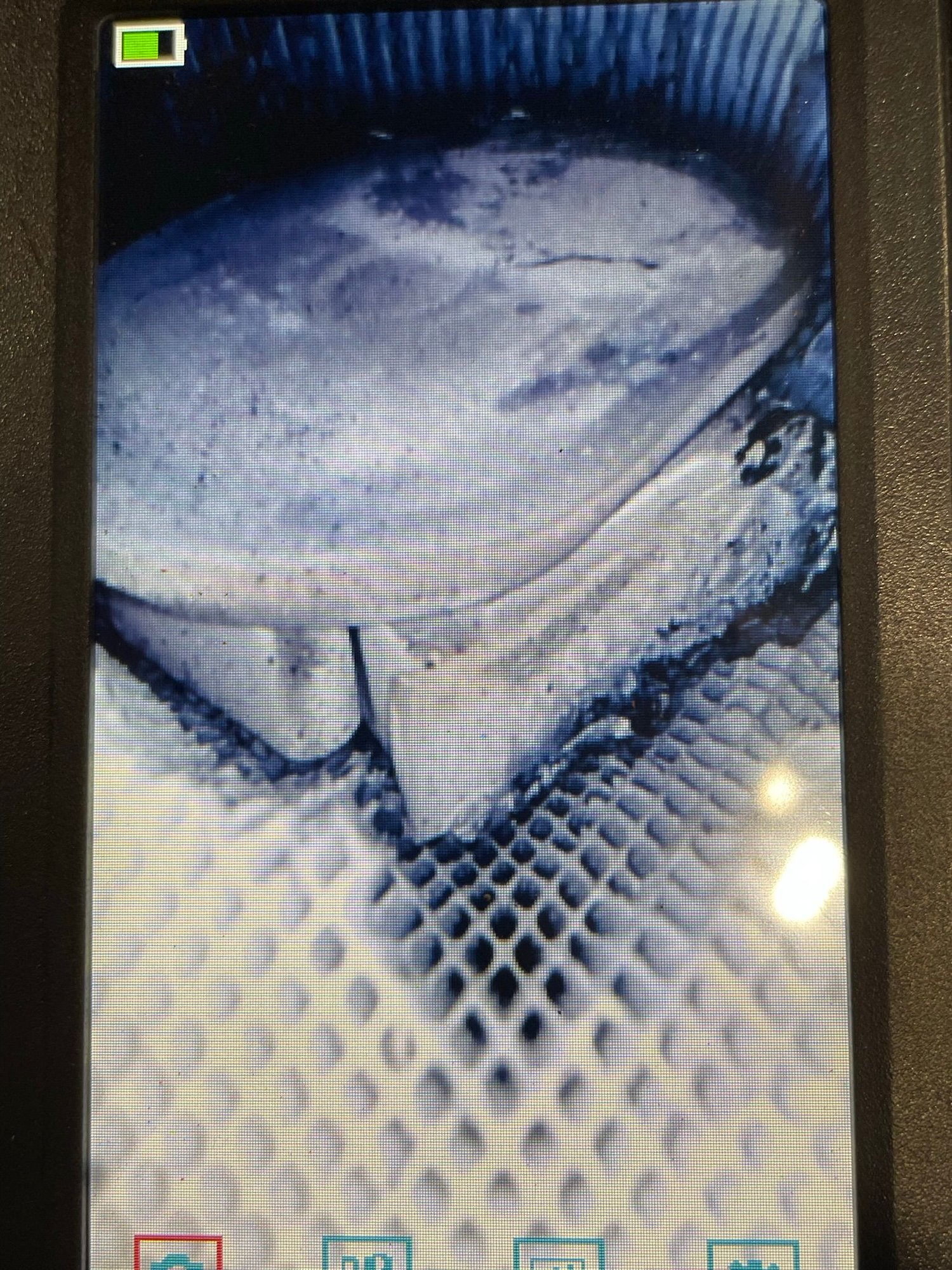

As suspected, the rest of the wastegate is sitting on top of the cat honeycomb.
