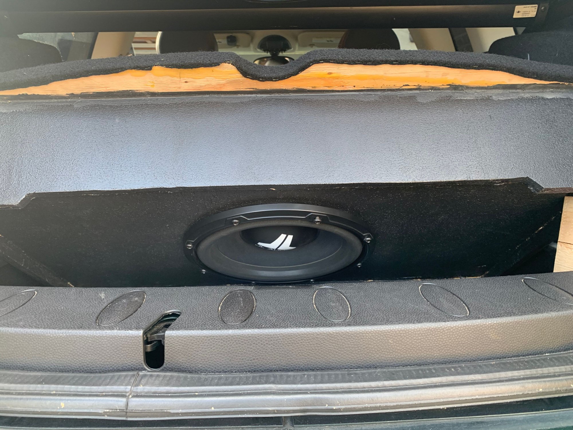

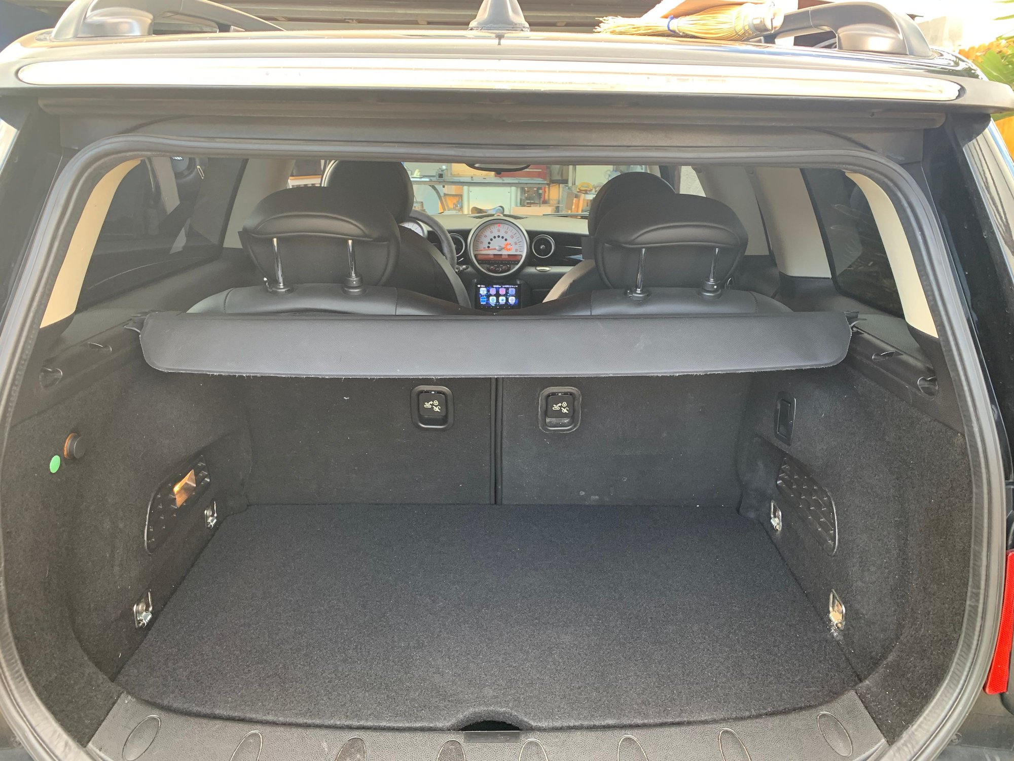

Hello All,
So i have been slowly working on the countryman on the weekend, One of the projects i been working on was replacing the unseat speakers.
Currently have a woofer on order, but was working on removing the old ones,and confirmed that the base speakers in my countryman have glued in woofers. In an effort to separate them it was working on removing the enclosure but ran into the problem that the hole in the floor mat is not large enough to remove the enclosure. In the pictures attached, Figure 1 is the woofer with the grill removed. Figure 2 shows as far as im able to easily move the flooring out (it seems not to budge any more past this). with the green lines represents the edges of the enclosure. So far ive been able to get it only partially out but it seems like its to wide to fit in the hole.
I was looking for pointers or recommendations on how to remove the enclosure. I think im not approaching this correctly
Any help is greatly appreciated! thank you!
(PS. Pardon the dirty carpet)
Figure 1
Figure 2
