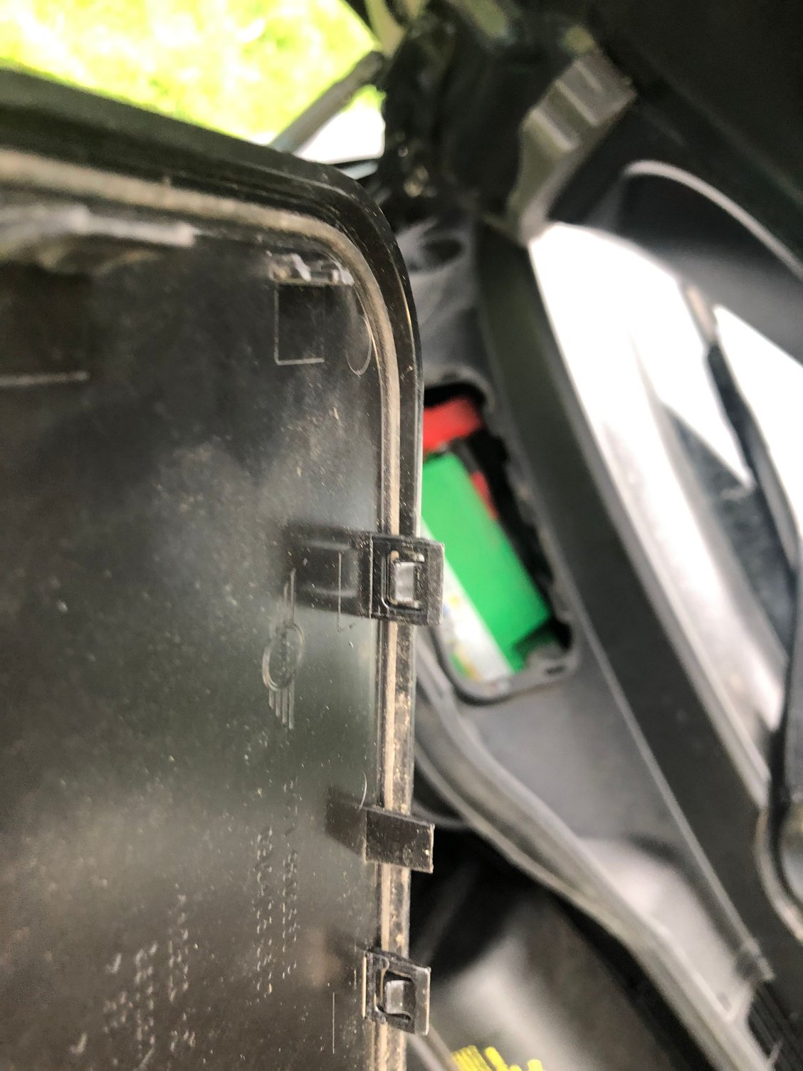

I just checked and the snap on the battery cover was broken. Can this small thing really lead to a leak? I’ve attached photos for you to check out the seal and the snap. Should I still use a automatic car wash?
Snap is broke

Looks like its sealed down and the cover should be fine and seal down. You might have a bad front window repair or maybe a door seal or someone cracked the side window down?
Check those out and till you find it i would hand wash it.
