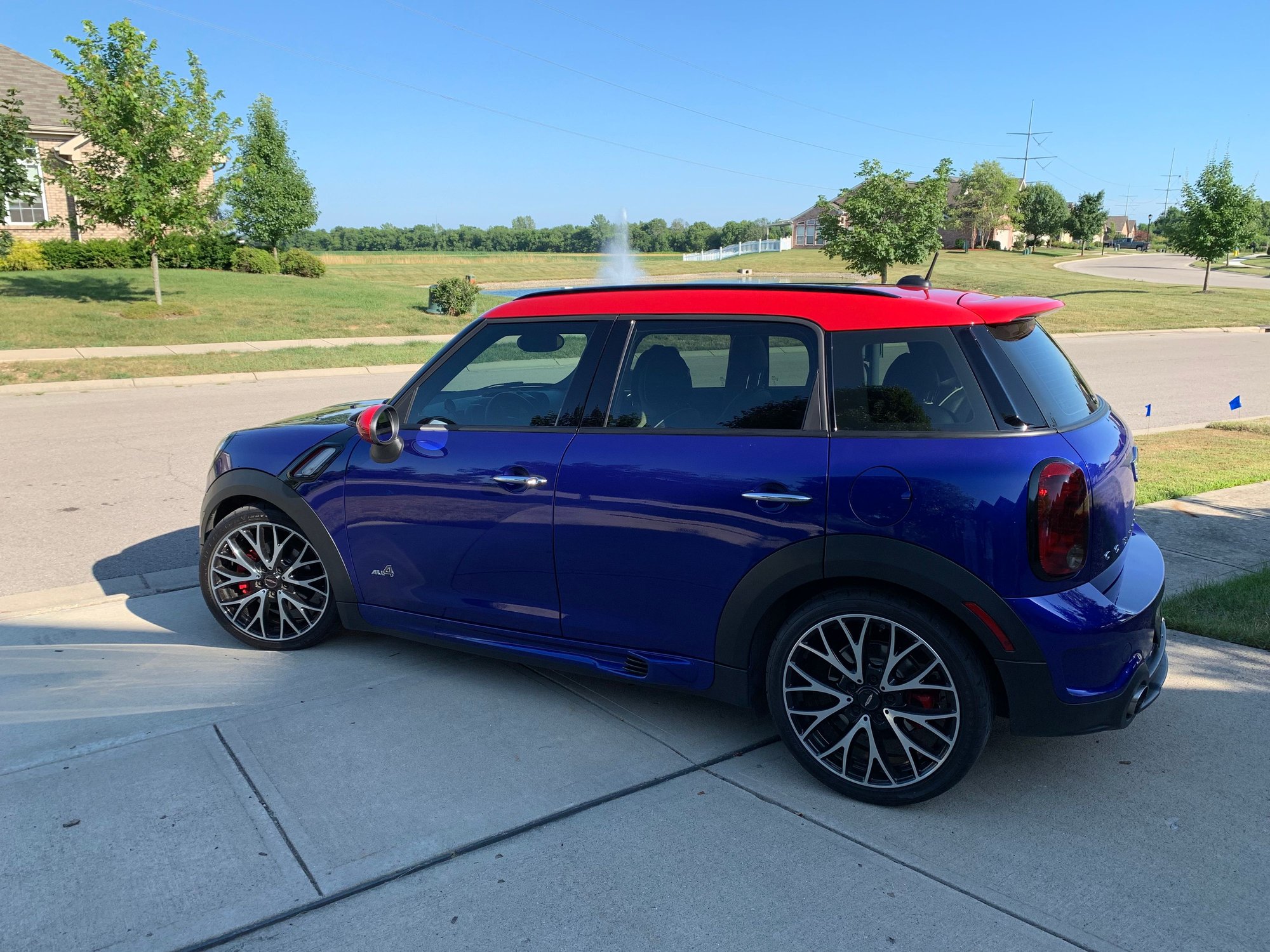

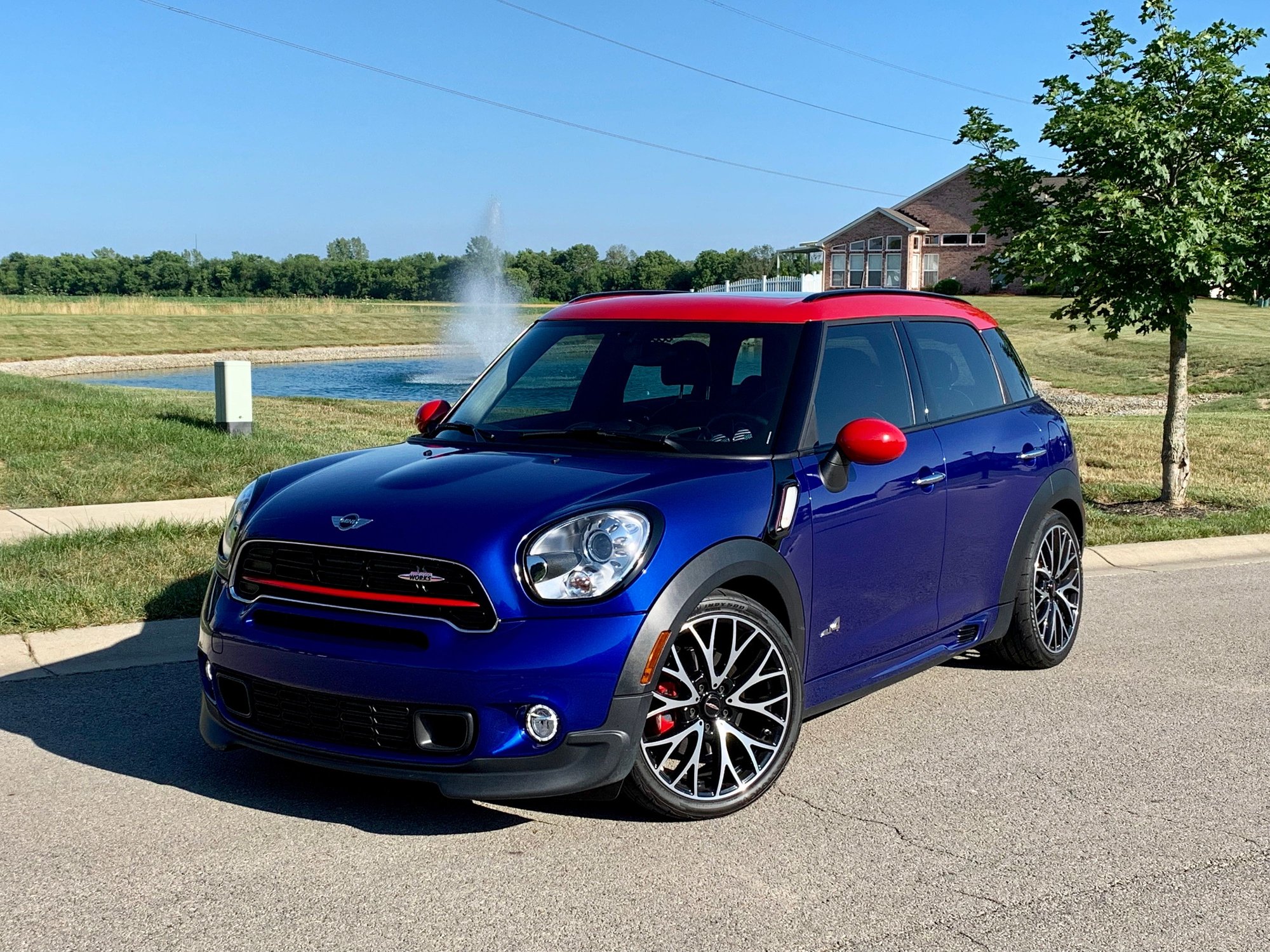

I’ve done Eibach Sport springs on three Mini’s and two Lexus’ and always liked the change. My current R60 JCW rides smoother than stock with them and not too low to worry about much. That said maybe a slightly lower spring would look nicer. I think NM is a slightly lower option. Living in Ohio I understand the need for the All4 and some ride height too. Coil overs could give you the option to raise the ride height in the colder months too, but a nice set is going to cost way above what a set of springs is. I was able to find the Eibach under $200, new, tax and shipping included.

I haven’t done anything else..., yet. The Eibach spring was a minimal drop from the JCW, so I haven’t done any alignment work. I would like the sway bar upgrade. The camber is pretty serious in the rear from the factory, but I’m used to going through tires quick from the Lexus. Any yes, stock shocks for the same reason above. I have yet to feel the bump stops. If you go any lower than Eibach I would look at a belly pan to go with it, if for nothing more than the winter driving.
i ordered the springs before the car was delivered even. Working on hardware upgrades tomorrow for a stage 2 future. Then maybe the sway bar and an alignment!
