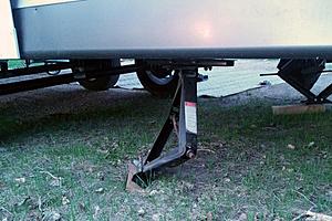

Originally Posted by Rich Rodichok
or, why couldn't I use RV jacks like below with a home-made synthetic or wood block with a slot to accept the pinch weld. (just had a new Trex deck installed and have some extra lying around).
RV Jacks
Maybe I'm over-thinking this. What do I need to safely get the car on 4 stands without breaking the bank? After all, the jacks won't see all that much use. I just like being able to do some things myself.
OMG! I wouldn't trust 4 of these holding up the entire car! It doesn't look like there is enough support to prevent forward backward movement and the stands tipping. RV'ers usually leave the wheels on the ground and block them right?
This is what I imagine could happen...
Yeah, I nixed that idea early on in my thinking. The plywood blocks worked well, though. And they cost me nothing but the time to build them.
