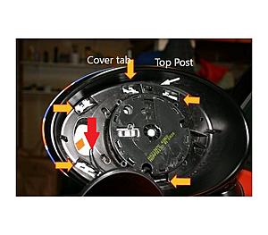

What I had to do was remove the mirror caps as well, to reroute the wiring for the heated mirrors. Just slide the wiring out the back and reinsert it to the other end of the mirror. Very easy, and simple. No rewiring or anything like that. You'll see what I mean when you go to do it.
See the mirror in the attachment, note the broad red arrow pointing at the wires. Those are the wires. Just pull them back thru, and poke them thru the other end, towards the car. At least that's what I had to do. No issues.
