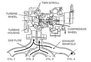

On second generation the JCW engines have a twin scroll. And as pointed out earlier all of the F's are dual scroll. Dual scroll makes the turbo more efficient at lower RPMS and reduces lag. It is simply design change in how the exhaust manifold feeds the turbo.
The scrolls are where the exhaust gas is compressed down and forced over the turbine wheel. In a single scroll all of the exhaust from all 4 cylinders is forced down into a single scroll on dual scroll the manifold system is split and two scrolls are utilized. It is a more complex design and more expensive but it is also leads to improved fuel efficiency and response.
FYI: Superchargers are more efficient and you may see more of them in the future.
how do you mean Superchargers are more efficient? Superchargers take power to make power. My Cadillac CTS V at 13psi made 550whp and turbo CTS-V at 13psi make 650whp
