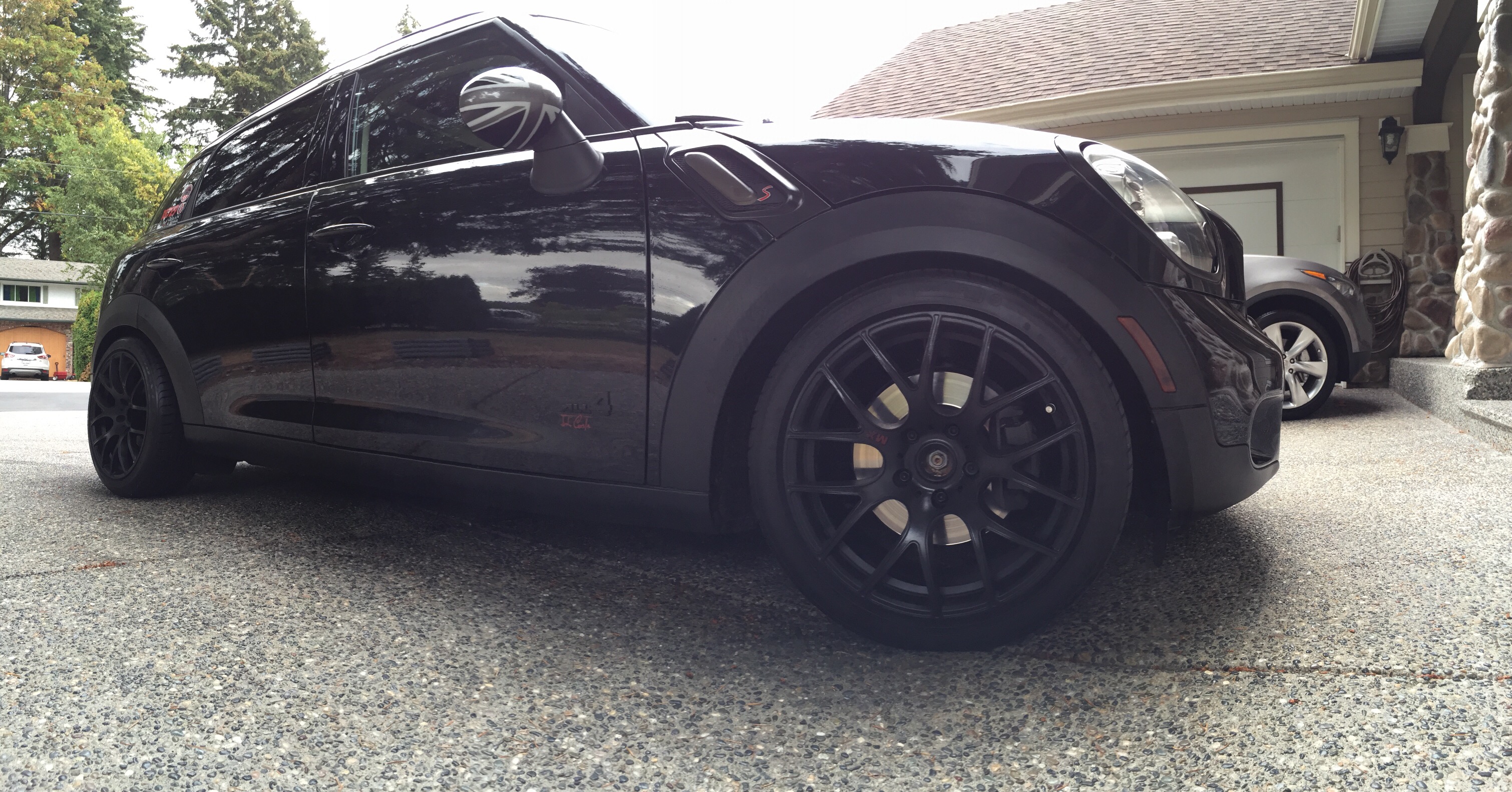

Springs
DIY here:
https://www.northamericanmotoring.co...ountryman.html
Then down the road you might want to add some spacers for a wider look.
https://www.northamericanmotoring.co...l-spacers.html
Do you have an All4 or just the FWD?

nice stance.. is this spring dropped?
Nope, stock height just with wheel spacers.
Thanks. I think I saw the post on this where they're using 15mm spacers and 19" rims... Fills the gap really well.
