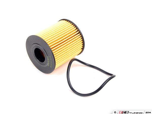

Mann / Mahle are good ones , the factory ones are Purflux for the Gen 2 . We have the kits below which includes New Oil, drain plug , filter kit, and crush washer.
Gen 2 MINI Cooper 2007+ R56 R55 R57 R58 R59 & R60 R61 ( Oil filter housing on the driver side front of the engine )
http://www.ecstuning.com/Search/SiteSearch/ES2497576__ES2581327__ES2581338__ES2582017/
You will need to get the socket for the oil change:
27mm, 6-Point Socket, 1/2" Drive
http://www.ecstuning.com/Search/SiteSearch/ES240947/
Filters only: Mann and Mahle don't come with the crush washer by themselves so you will need the washer x 1.
http://www.ecstuning.com/Search/SiteSearch/11427622446/
Crush washer: 11137546275
http://www.ecstuning.com/Search/SiteSearch/11137546275/
Oil change DIY - We have the 0-40 Euro Mobile one linked in the kit.

Mann Filters are great. See other options we list here.
