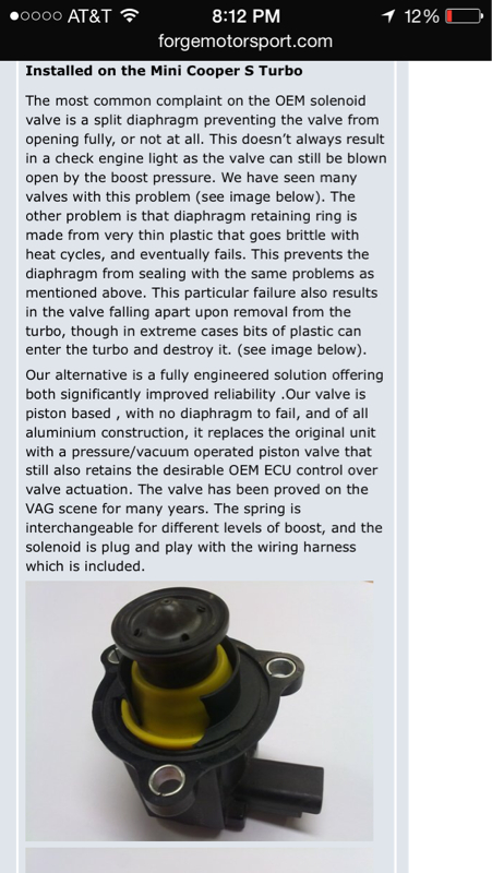

So I took my car to the mini dealer to see what their diagnosis is.....and the service advisor says need a new turbo....$3300 to replace!!!! Now I'm waiting for service manager to call back...,,:(

Originally Posted by vaselas13

Originally Posted by shark715
Curious why you just did not go with what your mechanic was telling you. Sounds like you have a lot of trust in him (so long as he is up to date on current BMW technology, I've come across some old timers out there who are not current with their technology education, and I would be afraid to let them touch my car for anything more than the basics). Then again, you really don't know who is working on your car at a dealer. There are some brilliant technicians, and unfortunately some real flunkies too.
I do trust my mechanic but wanted to see what the dealer would do for me and get their diagnosis! So it's seems the factory bov tends to go brittle and pieces of plastic could go into the turbo and ruin it! Btw dealer contacted mini USA and they're willing to pay 50% of the replacement bill!
no doubt 50% is better than nothing, but if there is a defect in the design, wouldn't the right thing to do to be to extend the warranty on that part for all owners?
