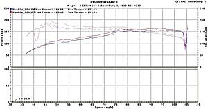

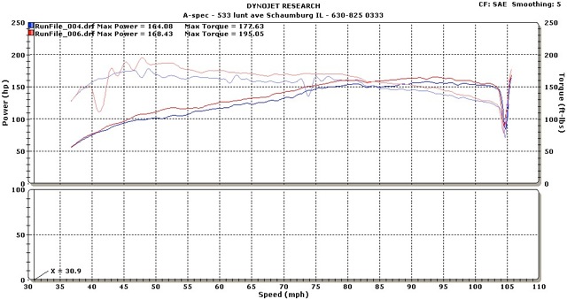

As a test, I also decided to put my bone-stock MINI on the dyno and see what it made before and after (not expecting any difference, but hey...they got a dyno, why not?)
Here are the dyno results:
Chicagoland MINI Cooper Walnut Blasting: A-Spec Tuning-wr3cej7.jpg
Before HP: 164
After HP: 168
Before Torque: 177ft/lbs
After Torque: 195ft/lbs (Not actually accurate as it was a spike at the beginning. But overall you can see it's about 10ft/lbs difference.)
We actually saw a small increase! He did warn me that this could be to outside factors (outside temp, engine temp, dyno error, etc). But hey..I'll take what I can get.

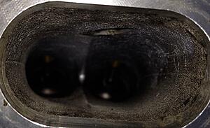

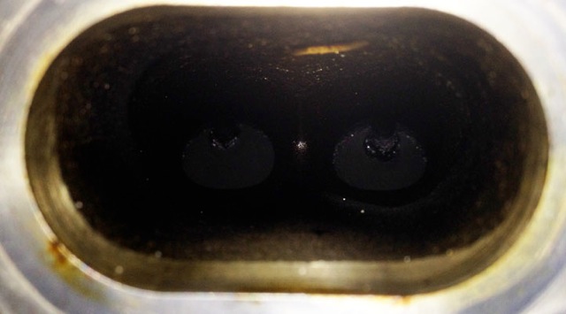

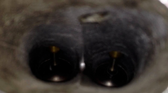

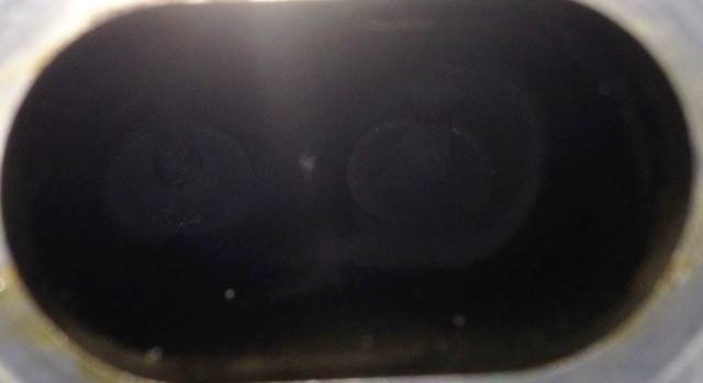

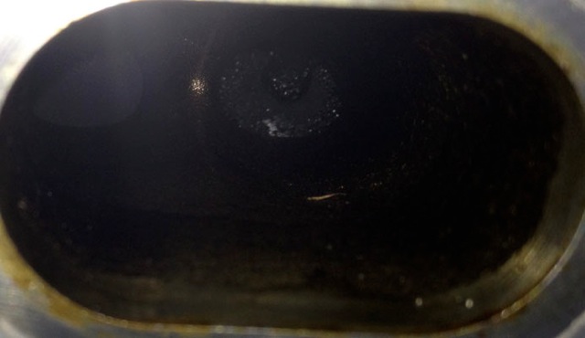

Here are the valves. Not as bad as I thought, but still pretty bad (Before):
Chicagoland MINI Cooper Walnut Blasting: A-Spec Tuning-qv8tbmu.jpg
Chicagoland MINI Cooper Walnut Blasting: A-Spec Tuning-suqvwiw.jpg
Chicagoland MINI Cooper Walnut Blasting: A-Spec Tuning-mphhiyo.jpg
Chicagoland MINI Cooper Walnut Blasting: A-Spec Tuning-h9xk5ol.jpg

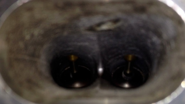

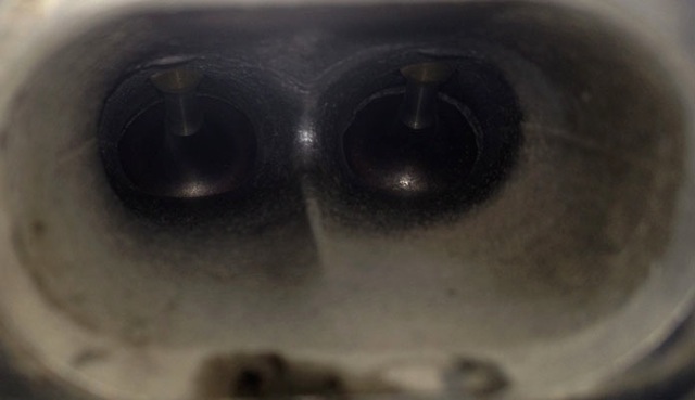

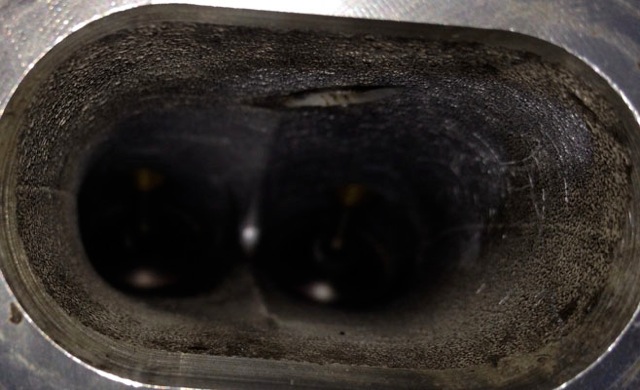

And after (Nice and clean!):
Chicagoland MINI Cooper Walnut Blasting: A-Spec Tuning-veskfbw.jpg
Chicagoland MINI Cooper Walnut Blasting: A-Spec Tuning-gsxhuha.jpg
Chicagoland MINI Cooper Walnut Blasting: A-Spec Tuning-n78iwse.jpg
Chicagoland MINI Cooper Walnut Blasting: A-Spec Tuning-1dxaaub.jpg
As you can see, they did great work! And the best part is that all this costs only $300. If you want to do a dyno run, add $100.
