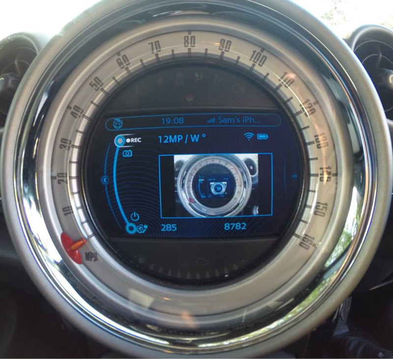

GoPro tested and working in 2011 Countryman...

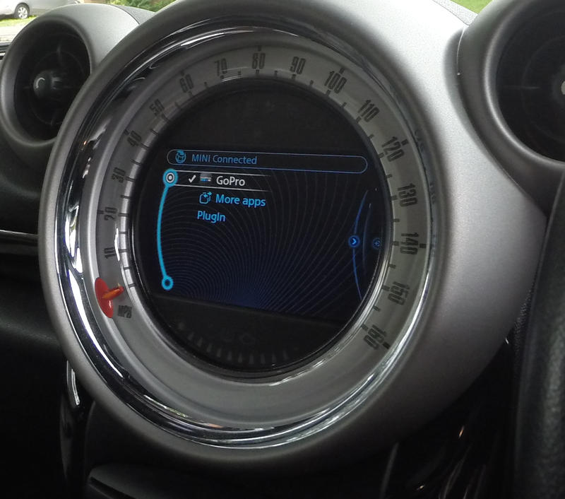

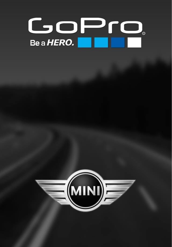

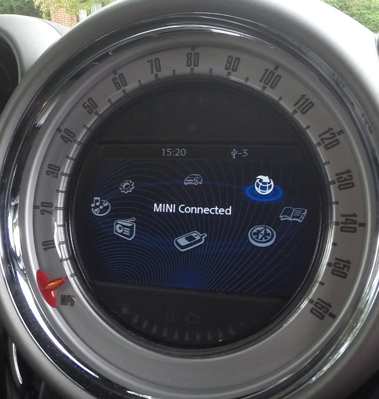

I've got the latest MINI Connected App installed on my iPhone 4S, the latest GoPro App installed, both in the iTunes Store. Connecting iPhone through BMW/MINI Y-Cable. Have your GoPro connected to your iPhone through Wi-Fi. Launch MINI Connected, wait for the usual list of options to load, Plugin, Driving Excitement etc. Scroll to More apps, and you will find GoPro App listed, Launch and you're good to go. Alternatively I think you can Launch by selecting the GoPro App on you're iPhone and then connecting the phone to the cable.

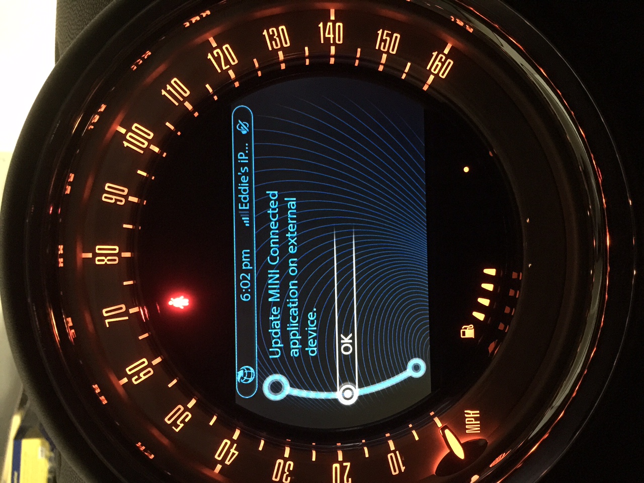

Tried again today when I got home from work. Still no luck. This message did pop up at one point: "Update MINI Connected application on external device." I've checked and I have the latest version of the app. Not sure what else to do. Guess I should go to the dealer?

Yea, if you updated the app, maybe they need to flash the Nav driver or there is an error. Your under warranty they will cover it.
