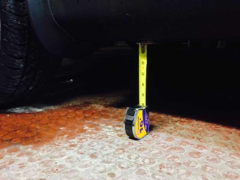

Big tires on R60 Mini Countryman
Hello everyone,
I ditched the 18" run flats that came with my 2014 Countryman sport package and got a set of:
225/55R-17 Kumho Ecsta 4x (26.75" outer diameter)
17x8 moda MD17 BDC
from Tirerack.
This raised my car by over an inch, and now gives me plenty of clearance for the massive Manhattan potholes. Not to mention the superior ride comfort and reduced noise. For those of you looking to change tires, this setup is highly recommended. Wheels look good, you still have plenty of clearance around the wheel well, you might even have another 1" diameter overall to spare.
Tirerack says this tire/wheel is untested, not recommended, so just thought I would share my experience. Here's a picture of the resulting ride height, just over 8" clearance. I can now put my head down there!
If anyone's looking for my original set of run flats and sport wheels, they are on eBay.
Just wanted to verify that it's absolutely worth it. Really feels like a different car, a better car, now. I just had to get an extending lug wrench from Amazon ($14), a 1.5 ton scissor jack, battery powered impact wrench (from Harborfreight), and the $55 tire repair kit with air compressor Slime package on Amazon.
The lug bolts are M14x1.25, but on these moda wheels, the locking tire lock bolts that came with my car didn't fit. The head was too big. So I got a set from ECS, the internal star configuration, and now all good.
Thanks to all of you who shared tire/wheel sizes and how much bigger I could go with my tires.

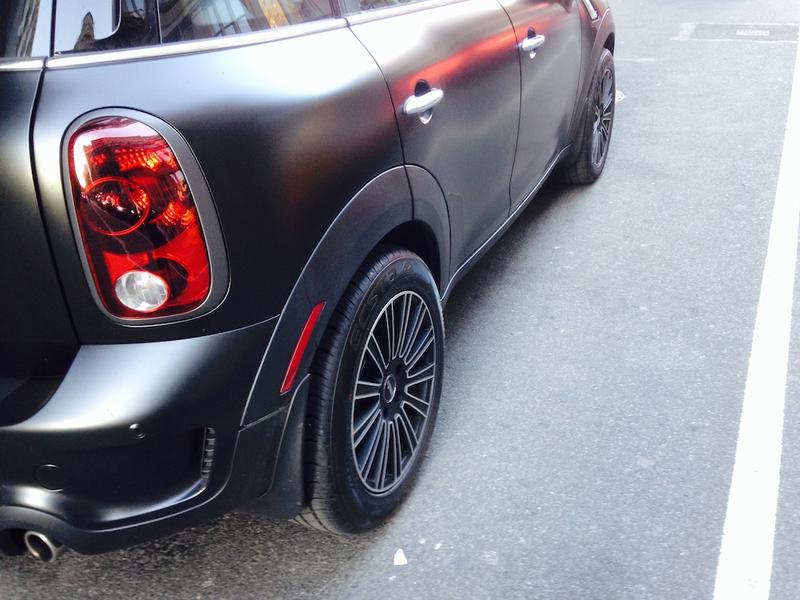

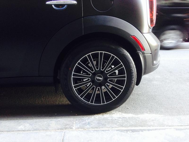

Any pictures on the overall new look?

Thanks for posting - this is a cheap/easy way to get that extra lift!
I'd love to see photos as well.

Some photos of the installed tires. Here you go!

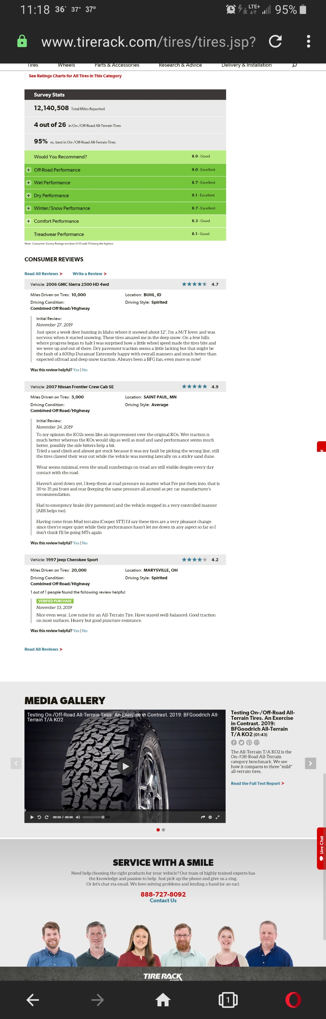

I have thought of these, but their snow performace is nowhere near the dunlops i run now (i have there on my 1997 gmc v6 5speed 4x4).
BFGoodrich ALL-TERRAIN T/A KO2 in size 215/65R16.
https://www.tirerack.com/tires/tires...6KO2&tab=Sizes
