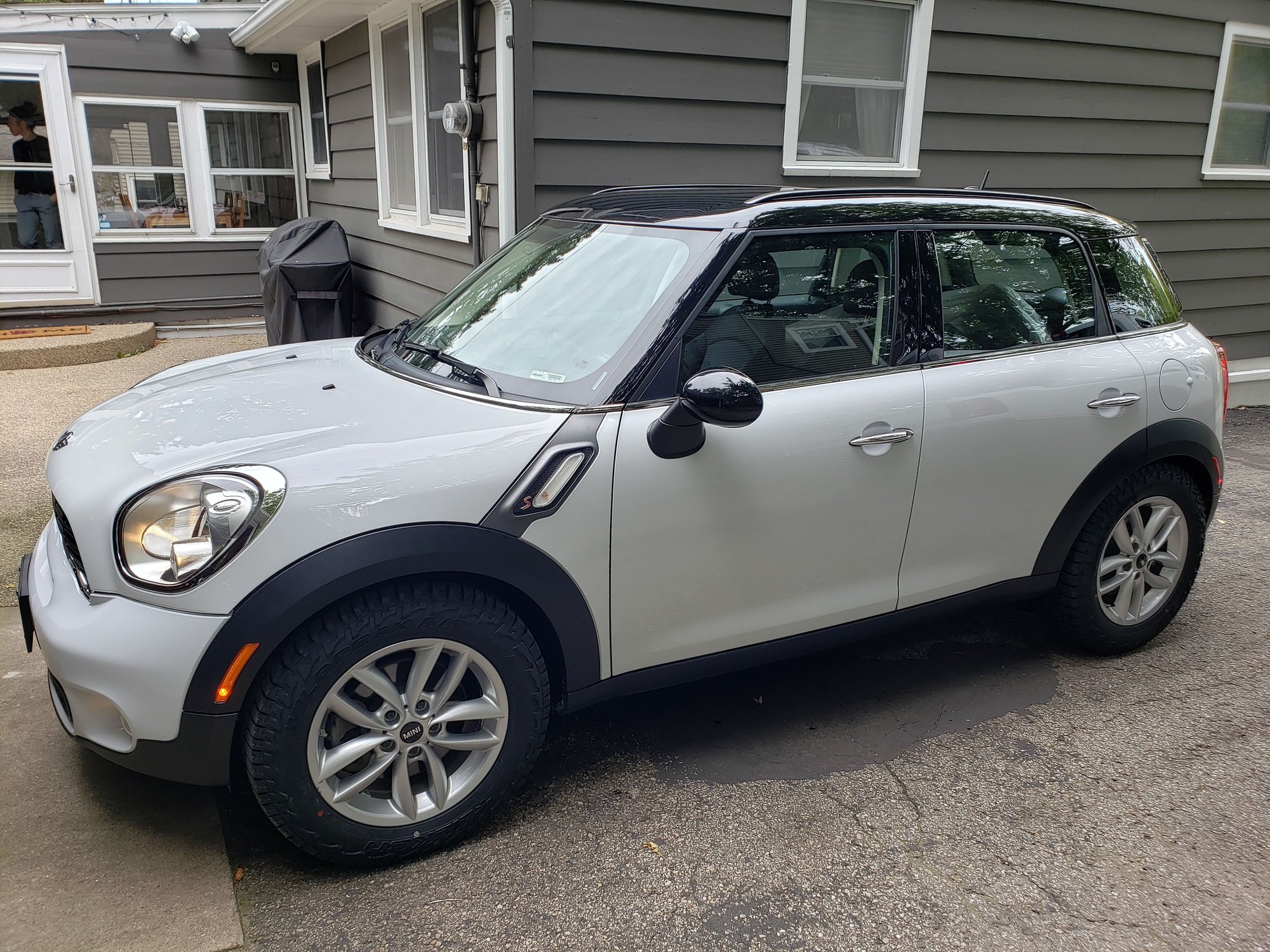

Hey all, creating this post to show a tire size I haven't seen fit before. I had done a lot of looking but couldn't find confirmation on this size fitting. Up until now the largest tire I've read fitting is 205/70/16 (27.3" x 8.1") and I went for a 215/65/17 (28" x 8.5"). These were my goals:
1. Biggest tire possible
2. No cutting fender plastic
3. Stock suspension
4. Stock wheels (17" split spoke)
5. The tire must be an All Terrain (MN winters and I only wanted 1 set of wheels/tires)
The winner.... 215/65/17 Falken Wild Peak AT3
It's super close but it fits and it doesn't rub. My (wifes) car: 2012 Countryman S auto/FWD (totally stock) Next up is to coat the stock wheels gloss black. I think it looks pretty badass

Oooooohhhh, fills the wells nicely!

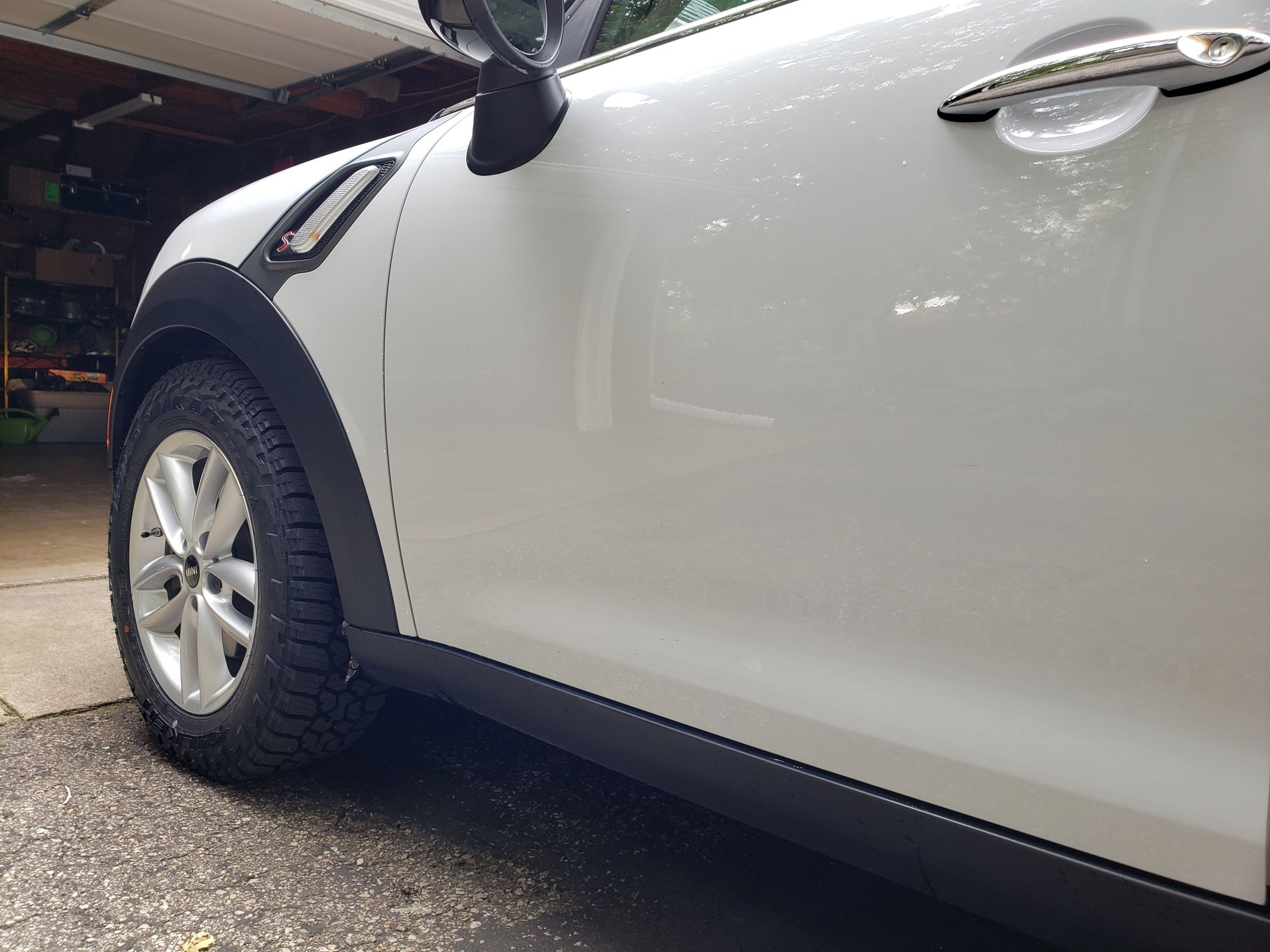

Here's the updated look after powder coat. I'm pretty damn pleased with the results.

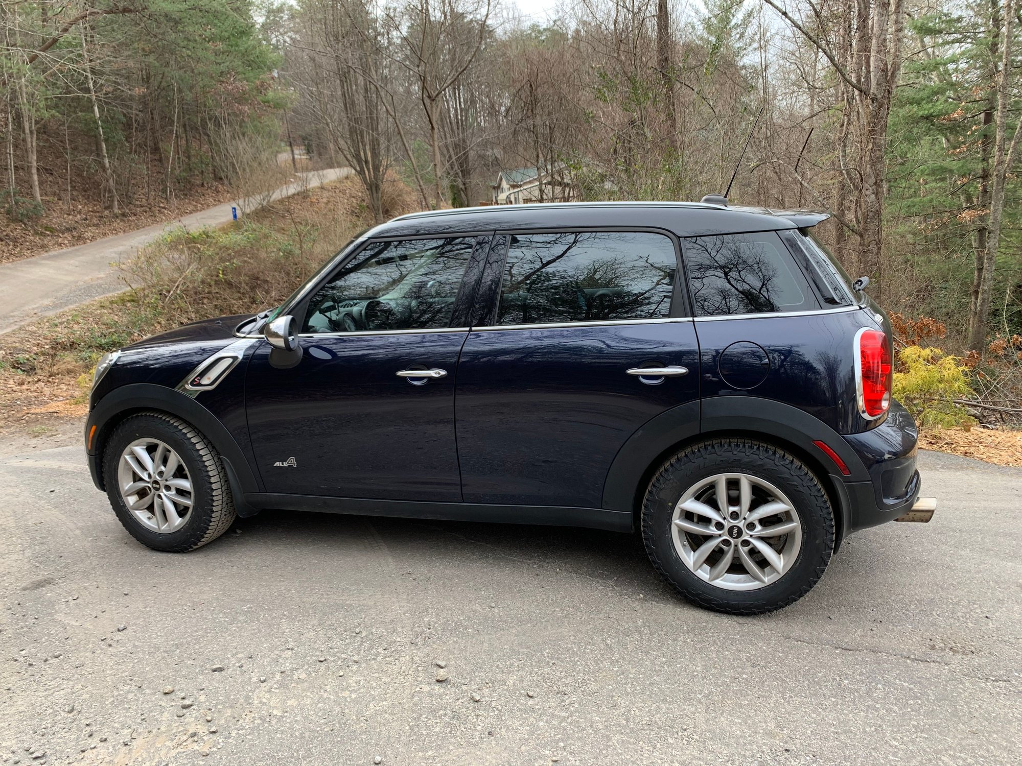

28” do fit. Just installed the same size with some 215/65/17 Falken Wildpeak Trails.
It’s a relatively new tire by Falken specifically made for CUV/SUV. This is on stock height suspension. It was close in the rear, had to take the little mud flaps off in the front of the wheel well. Other than that no problems. Getting aligned as we speak.

That looks really sharp!
Bravo! That looks super sharp! I'm thinking just a smidge smaller 215/60/17 on some anthricite 141s for my car..would feel more comfortable with a little more open space in that wheel well since I run through dirt roads and dodge pot holes. I'll just keep the Efficient Grips RoF (summer tires) on the 18" TurboFans and use them up a little more. The EFSummers seem to be doing ok here in the colder temps (40-50s), the rain and even the pot holes. They are a little stiff but they're rolling a long.
