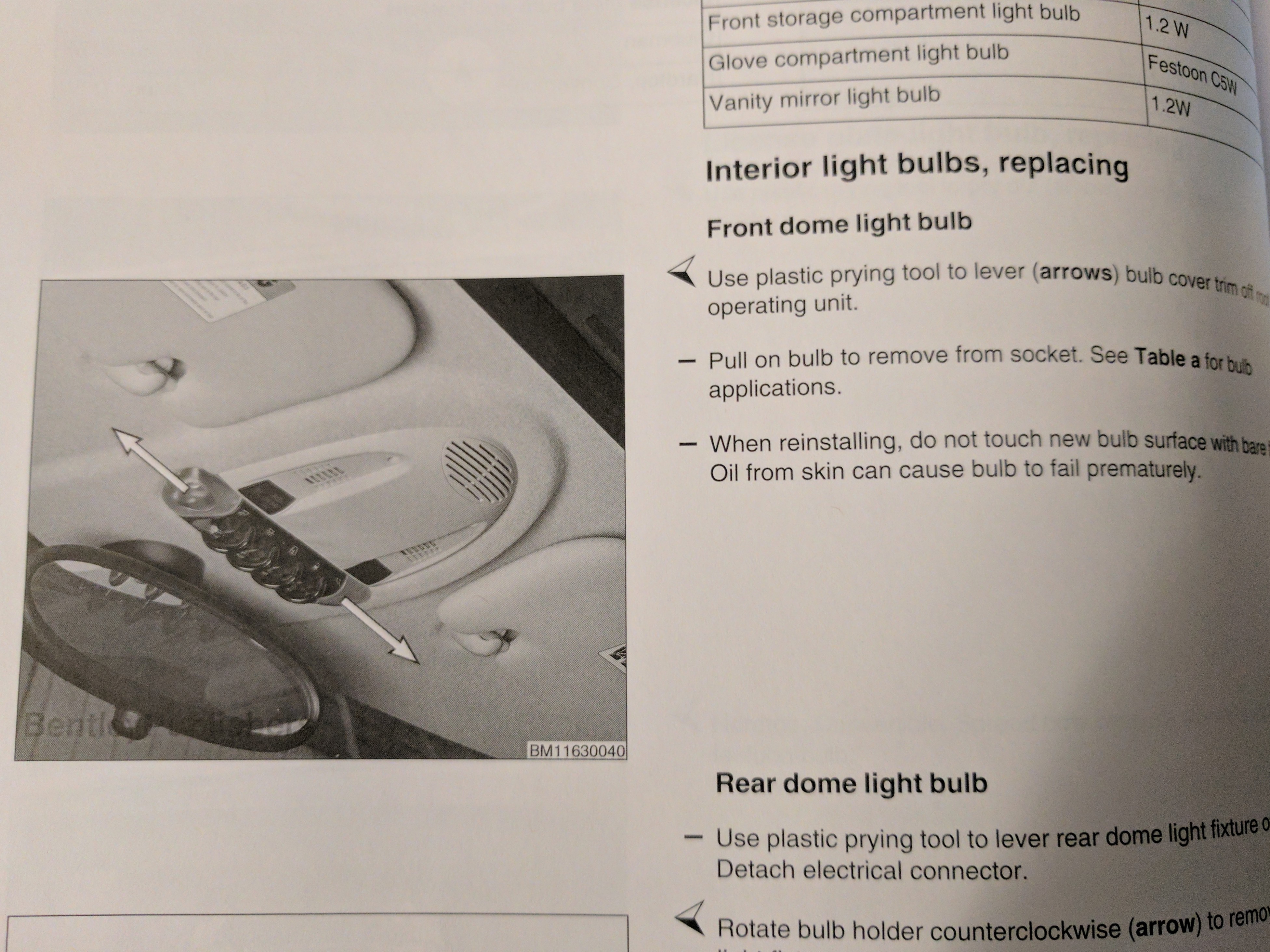

To change the map lights, you just need to pop off the covers sideways. The first time I did it to switch out the incandescent bulbs for LEDs, it took me over an hour using those instructions. This time, it took me less than five minutes to switch out for brighter LEDs.

ok. I'm interested in the 5 minute approach to replacing the front map lights. Not the hour remove the console approach. But I'm lame. So explain this sideways move. I've tried and nada. Sideways out? Tried it. Stuck. Did you use a tool to pry it?
Thanks in advance. More thanks if you avoid sarcasm.

Did you look at the picture I attached from the Bentley manual?

I just installed the interior LED kit from ECS in my 2013 R59 and Mike (ECS) was very helpful with install instructions and various videos with super quick responses via PM. When it came to the overhead/dome lights I couldn't get it to move from the side as outlined in the instructions. I had to slide the trim removal tool into the front area of the dome light and pry down. It popped loose and I was able to complete the install. Just a little different than the side approach from the instructions.

I'll try it again.
