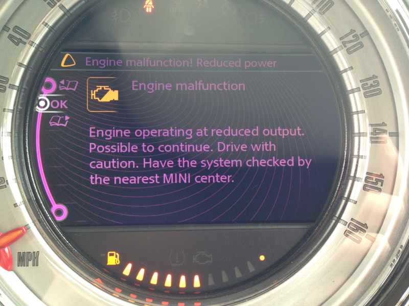

Yesterday I was moving the Mini out of the garage and I get a reduced power message.
I called Mini they said to have the car towed to the dealer on Monday. Has anyone had this before? Did you drive the car? It says it is okay to be driven but I don't want to drive the car if I don't have too.

I got the message friday morning when I moved to a different parking space. Drove the car normally for another day and it went away.

I have had that warning 4-5 times now. Normally I just power cycle the car a few times, and it goes away. One of the last times I had it into the dealer, they updated the ECU and it hasn't happened since.

Just turn the car off, wait about 5min, turn it back on.

The car can still be driven. Had it happen a couple of times. Eventually the warning clears on it own and the car runs normally. Since I had a small oil leak (the usual oil solenoid leak) I had it to the dealer last week. The VANOS solenoid was throwing erros causing the reduced engine power message. Replaced under warranty although I did need to find out what a VANOS solenoid was. For those interested, it is a variable valve timing device by BMW. Car seems to run better now.

Oh that's what it is. I did that several times and it still didnt go away.

Happened twice to me so far. Drove both times to the dealer. First time it was a tensioner. Second time it was the in-tank fuel pump. I personally don't ignore it, even if it "goes away".

Got the car back today it was a coolant sensor. All is well!
