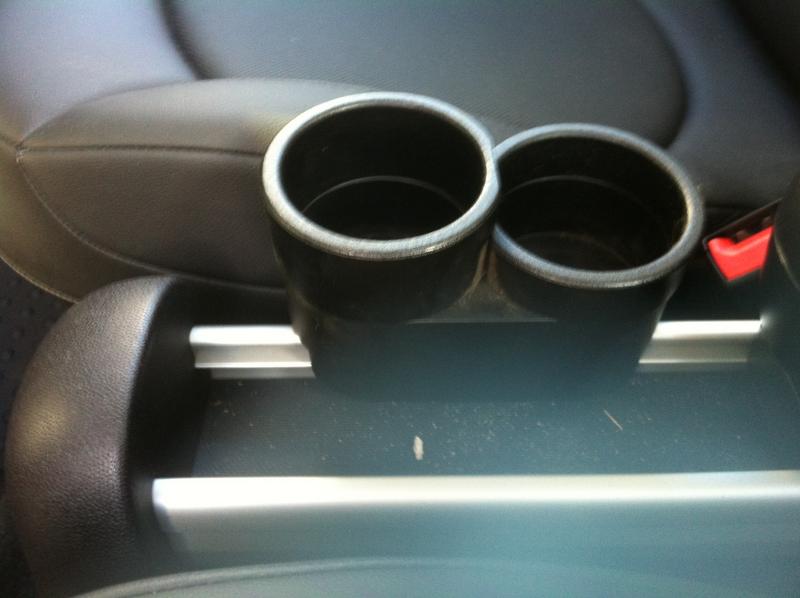

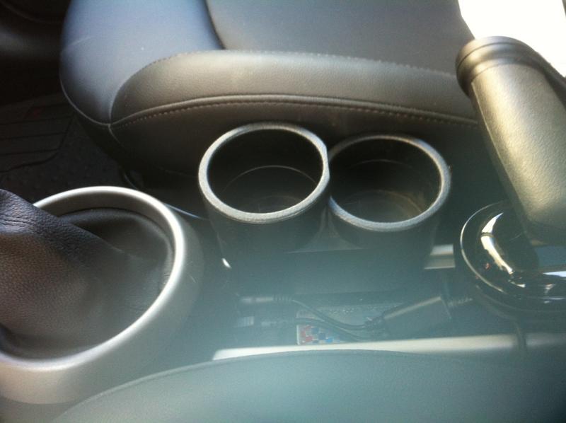

BMW cup holders work pretty well
Attached Thumbnails Cup Holder Leakage?-img_3142.jpg   Cup Holder Leakage?-img_3143.jpg   Cup Holder Leakage?-img_3144.jpg
