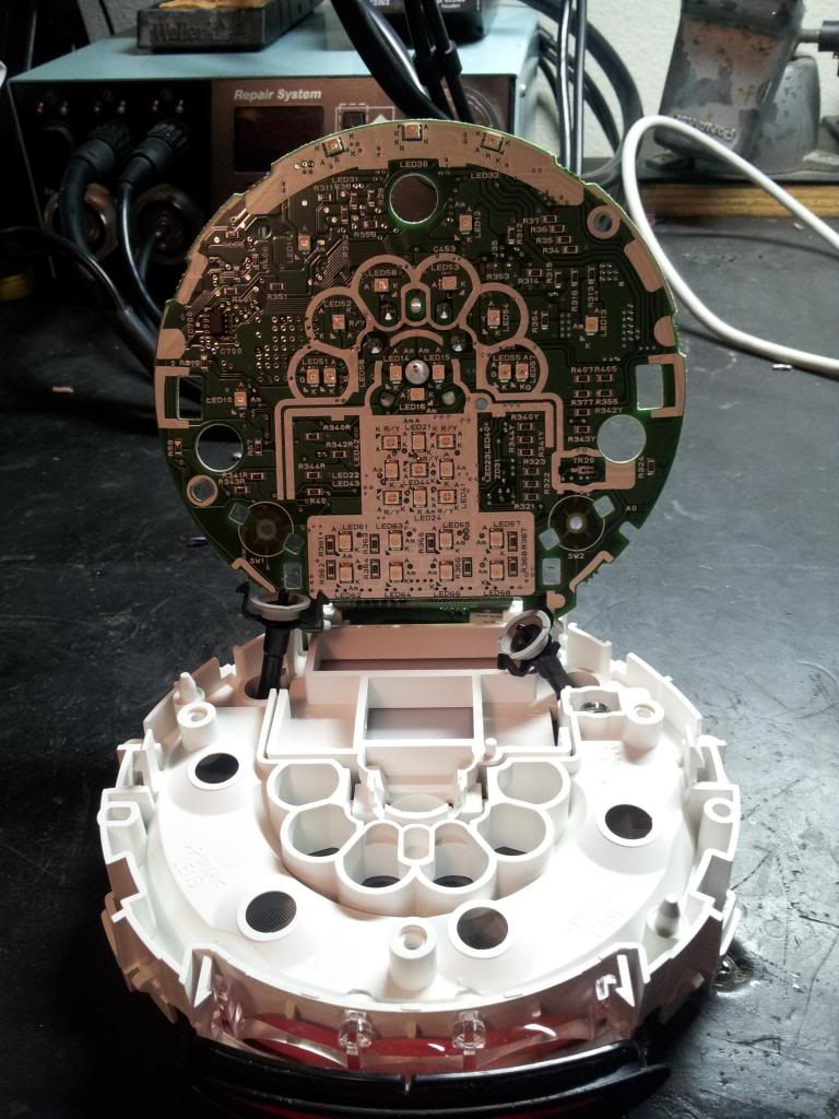

Had a bit of time to play today. Pulled the speaker out from under the drivers seat so i can pull measurements to see what i can fit under there. I have the speaker still out. Will post some pics of measurements tomorrow if anyone needs them for future.
Also had a few PLCC-2's from when i did the dash on my tundra and wanted to play so i did the backlighting on my Tech.
Also took a few pics that might help someone else in the future.
*Disclaimer, if you have no idea what is in the pictures then an LED change may not be a good option for you without a lot of research on what equipment and experience you should have to get it done without burning up your circuit boards.
Tach Opened up

Needle is red but i will likely end up going blue. Also need to pick up some hobby paint for needle backing color.....
Just in case someone need this one day i checked to see where the single color led's were on the tach.....
Odometer Panel backlight LEDs
Digital Speedo Backlight LED's
Needle and Digits

In order to give myself some sense of accomplishment today i had to at least finish the tach. I had just enough whites to finish.
Ended up using:
3 White for the numbers around the outside
1 red for the red line stuff (and i actually loaded the solder a little higher on one side so it angle away and didn't make the 6 pink)
3 Blues under the needle
4 whites for speed display
8 whites for odometer display
Blue Acrylic paint from hobby lobby on the needle, two coats and a clear coat.

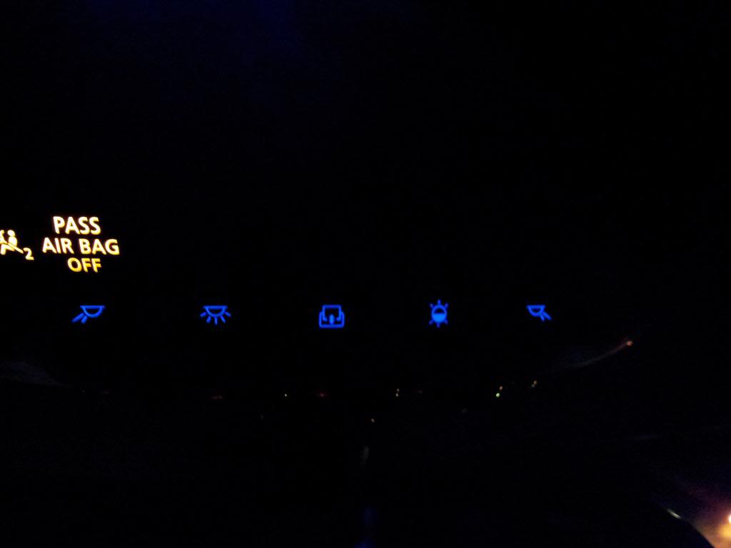

Cant figure out how to get the damn roof switch panel down to see what LEDs are under there and don't want to break anything.
Here it looks there should be screws in the little holes but in my car there are LED's in there for the colored accent lighting.
If anyone has suggestions i am all ears. I thought there would be some screws under the lens for the front seat "reading" lights but pulled those lens and there was nothing bulb a bulb in there.
Edit*
Score! The face just pulls off. Just had to get a 90 degree pick to get enough grab on it and wrap it in a small piece of cloth so i didn't mark the plastic up.
Direct pull down gets the plate off
First, there are two T-20 screw that hold this plate in.
Once the screws are out there are 6 tabs still holding it. Put a finger in the front hole and apply a slight downward pressure and press each of the tabs. Doing one side then the other and go front to back worked best for me. 3 of the tabs are seen in this pic.
LEDs for the switch function icons look to be PLCC-2's. Made my day. dont have to order another type of LED and i have enough blues to do these today. More pics to come.

Unplug the connectors (just a firm tug to get them out, i saw no latches to squeeze or press) Once this piece is removed you will see 4 T-15 screw on the back. These screw into the switch guard rails.
Once these 4 are removed the guard rails will come away easily
At this point the only thing holding the back portion on it some plastic spring clips on the arms that go down toward the ambient light locations. Be careful when squeezing these as they are fragile.
*Important Note* When you remove this the top piece will then pull away from the "main" plastic piece. None of the switches are fixed in place. They all float and each one has two plastic pieces (one on each side of the rocker) that are also not secured. The only thing holding them in is the circuit card that is not screwed down. Be careful not to lose anything.
Once the upper portion is away you will see the plastic section that closes contacts to make things work. The indicator LED's i needed to change are arranged along the top in this pic.
Plastic peels away easily, it's not attached. Just rests there. Now it's soldering time. This pic was after my blues were in place.
Final pic once it got dark.....
