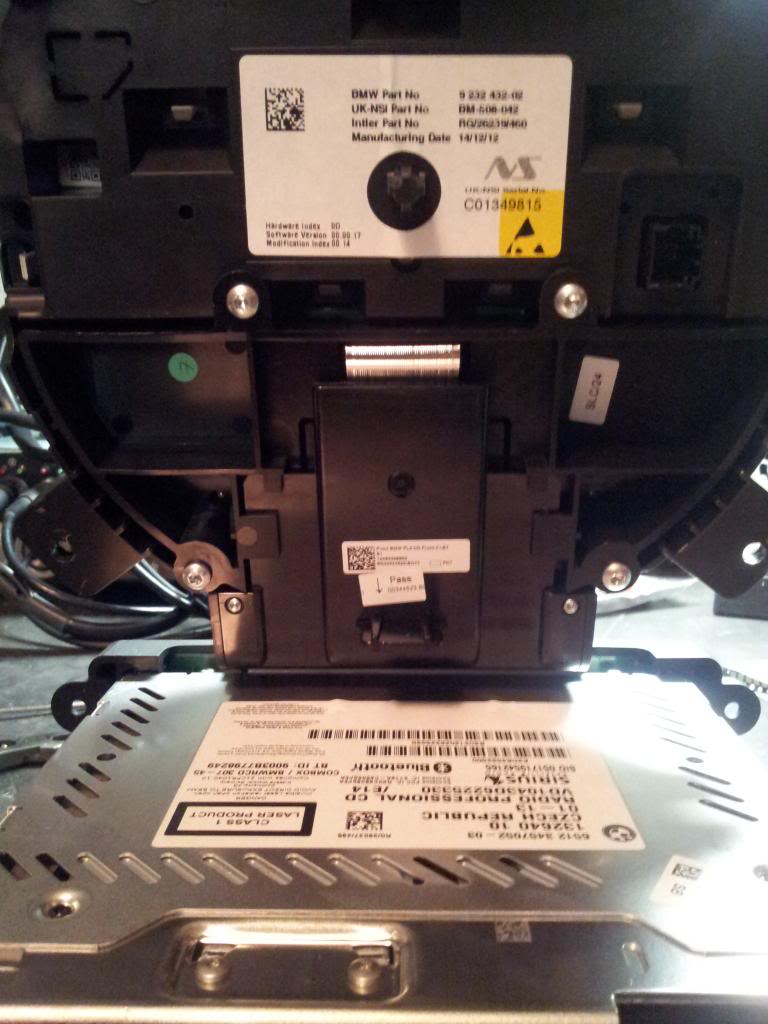

The speedo is attached to the stock radio so first you have to pull them apart.
A few screws will get it done. then you have to press back on a little platic tab to allow them to slide apart.

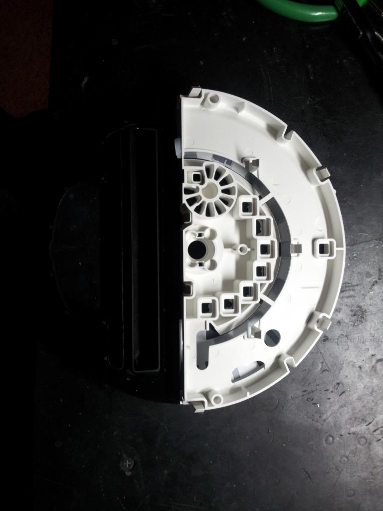

Once you have the speedo removed and all alone it's all plastic tabs holding the assembly together. Dis-assembly did not get picture but it's much the same as the tach. Pull apart layer by layer by applying pressure to the locking tabs and sliding things apart.

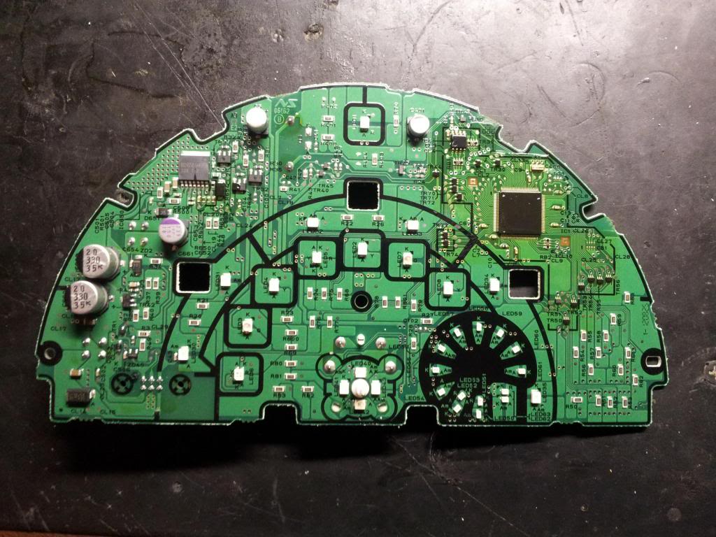

Now the gauge face will pull away from the PCB and you end up with this.
The individual black squares on the "inner arc" are the indicators such as fog lights, and cruise control. The longer boxes on the "outer arc" are the backlights for the speedo numbers. The needle LED's are the 4 around the needle shaft.
The black circle over to the right side is the fuel gauge. You will notice the last two corn kernels having two leds in it as well as the location where the fuel pump icon is visible on the gauge face. One of these is the amber one and the other is the red one for when the car is dinging at you that it's getting thirsty.

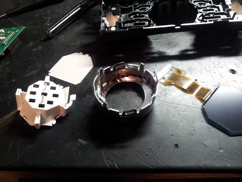

and for the A/C and switch panel.

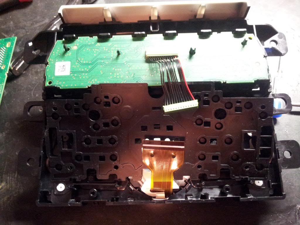

One of my pictures got messed up for some reason but once you get the plastic tabs to release and get the shell pulled apart you will see two boards. They are connected by a small set of wires. The plug is tight but can be removed if done carefully.

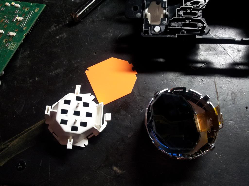

Once the boards are pulled off you have access to the back of the A/C display. There is an orange backing that needs to be pulled off and scrubbed to get the orange off.
Start with this
Put a little bit of kitchen scrubber on it and get that orange nasty off. I used a little bit of wd40 just because it can usually get nasty stuff off but i don't know if i needed it or not.

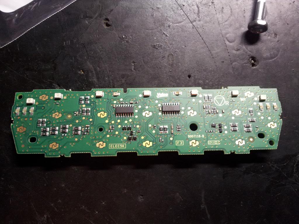

This is the switch PCB. Across the top are the indicators. The far right and far left are seat warmer buttons. You can see the 3 led's under each one that are the green level indicators. you can also see the indicator leds for the sport mode and all4 buttons.

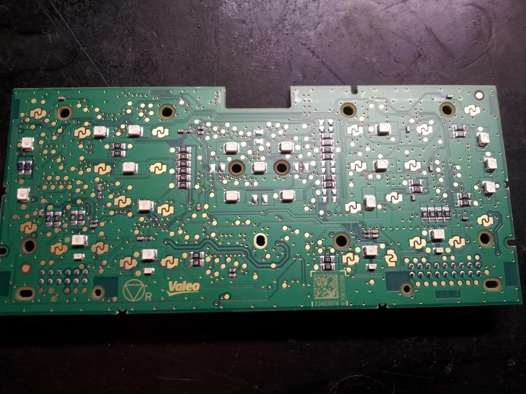

This is the A/C PCB. Far left is fan control, far right is temp control. On the temp control leave the top and bottom so the buttons don't look weird with a different color behind the red and blue icons. The center cluster of 5 is the back light for the display. I put white in mine and it came out that Cyan color. So it seems the glass has some natural coloring. That that into account when choosing you colors. and be sure to test it before you do the whole reassembly. Across the bottom you see sets of two LED's. The smaller one is the amber backlight for the button. The upper one is the color of the "on" indicator.
Start with this

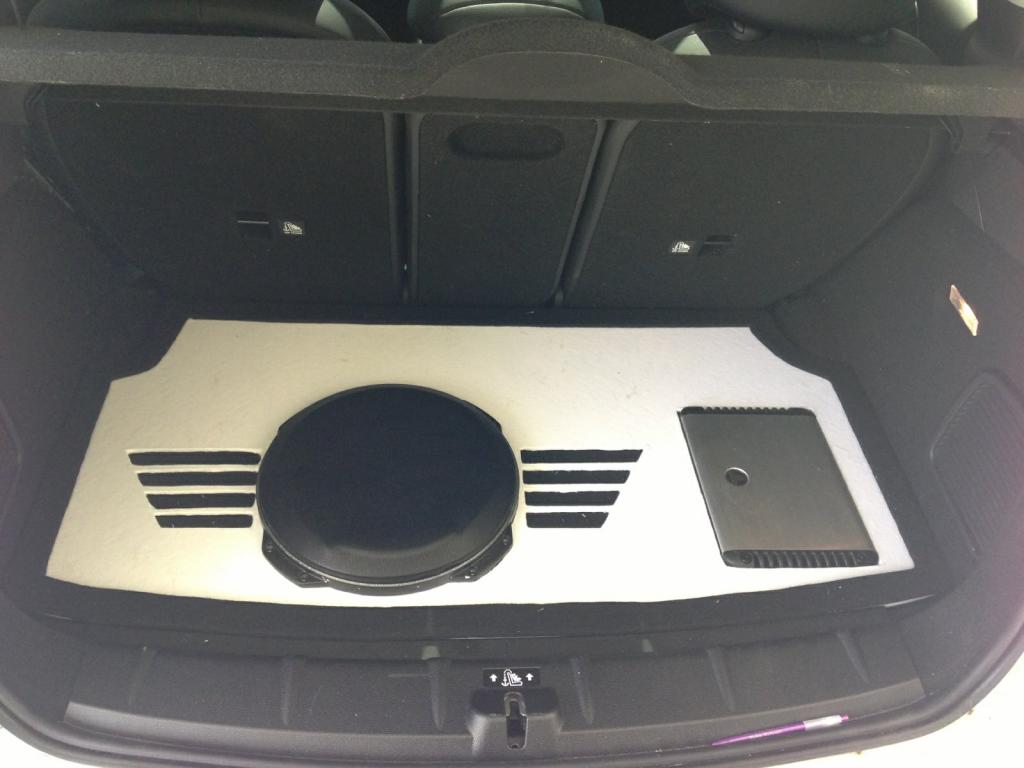

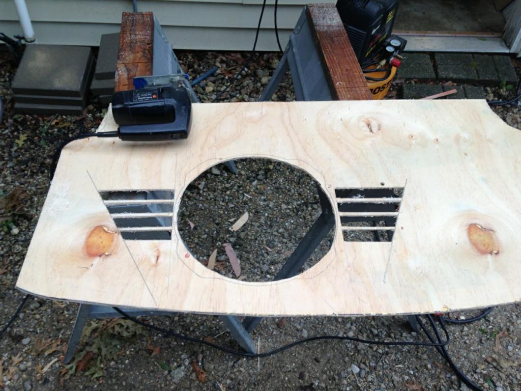

Had a friend of mine trade some speaker box work for some blue needles in his Tundra.
I think the black wings and white box sounded good but doesn't look as good in person. Likely going to do a color swap. make the wings white and do the cover black.

Good and Bad, Bad is obvious, had to pull it all out to clean. Good was now i had a great excuse to stop procrastinating the change out of that white fabric with the vinyl "pleather" so the box matched the car. Swung by hancock fabrics and snagged some up. Pictures to come in a day or so once it stops raining EVERY DAMN HOUR!
