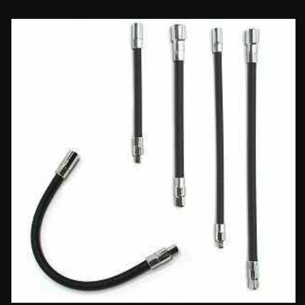

It's pretty easy to do if you have one of these:
Amazon Amazon
With a socket adapter and an 8MM deep socket. That upper-inner one is still a pain, but doesn't require as much contortion. I do recommend tying a string or something to the driver though, just so you can pull it out if you drop it. I dropped it once and had to use a magnet snake to get it out.

this is the tool needed
Attached Thumbnails Instructions for Removing Tail lights & rings-20150913_090420.png
