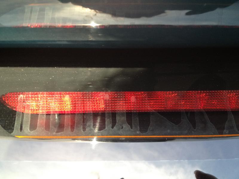

Hi All,
I just had my windows tinted and when I got home and took a closer look, I saw that there are now dried on drops of what I'm guessing is water or whatever they used to get the tint on inside of where the brake light is on top of the rear window. I am attaching a picture for reference.
Grrr...had windows tinted and now there's water marks inside my brake light...Help?-photowindow.jpg
Anyone know how to get inside of there to clean it? It's already driving me crazy!!!

Most likely water that was squeegeed out of the tint when they were putting it on. Wait a few days before you try and do anything to protect the tint. Then just try to lip a cloth between the light and glass or remove the 3rd brake light housing.

Before messing with it I would take it back to the tinter and have them deal with it. They caused the problem, so they should make it right.

Any tips on how to remove the 3rd brake light housing? I may take it back to the tinter, but I don't live very close, and if things need to be taken apart on the car to clean it, I'd much rather do it myself instead of having someone else messing with it. cringe.

THIS PDF shows how to remove the third brake light. It is courtesy of GOMINIGO.com and their wonderful Pulsar third brake light flasher. The Pulsar just saved my CM's rear end about a week ago from a HUGE 4X4 raised Dodge Ram piloted by a distracted person.

Thank you, thank you! Very helpful! Glad to hear your CM is ok!

You know what, I didn't realize this happened to mine as well until you mentioned it and I just checked.
Was removing the trim difficult?

Due to this post, I checked mine and noticed water spots from my recent tint job. Opened the boot, popped off the plastic housing covering the break light, and cleaned the area in minutes. Easy job. Housing just held in place by a couple plastic plugs/rivet thingies.

Just wanted to say thank you for the help, I was able to remove the back panel and get the water drops out with no problems. Looks much better!
