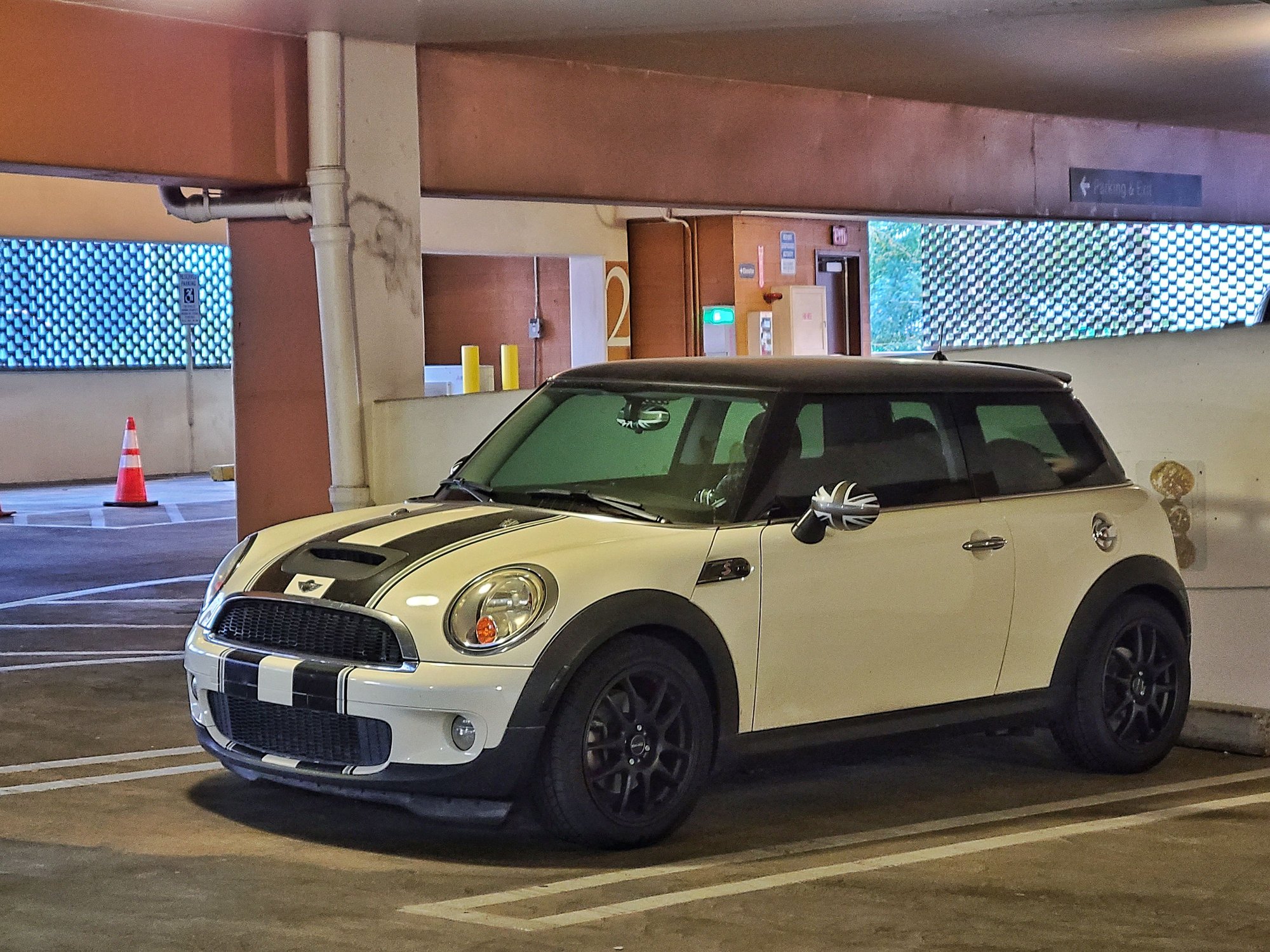

Two months ago, I purchased our first MINI, a 2007 Cooper S in Pepper White with the 6 speed manual, and just a tad under 97k. My wife and I needed another car for commuting, and we're looking for something with decent gas mileage. I wanted something fun for the commute, so I started looking at MINIs. We have a Ford Fusion for the family car, so 2 doors was fine. I had Turbo Volvos in the past, starting with RWD ones, and I maintained those myself, learning along the way. Saw some of the problems of the various Minis as I'd research ones available on Craigslist. I was a little worried about access in the engine bay.
I found this white one for sale not far from where I live, made arrangements for a test drive and went to see it. That car was such a blast that I decided to buy it, a couple days later it was mine. The man selling it had purchased it to tow behind an RV, but he ended up getting a smaller RV that couldn't tow a car.
I plan on changing the timing gear, I'm not noticing a rattle, but I also don't know if it's ever been done. The first oil change I did I was a little surprised at how to access the oil filter. The brake service reminder comes on so plan on doing the brakes next before anything else. It's throwing a code for coolant too cool, and the passenger seat wiring for the airbag/seltbelt sensor needs fixing, the final two issues I'll need to resolve.
Been enjoying the car so far and I am looking forward to driving it for awhile.

Nice job! Sharp looking car - my wife has a PW R53. Really like the stripes and the mirror covers!
Thanks! Unfortunately, the Arizona sun has cracked the black stripes, so at some point I'll want to replace those.
