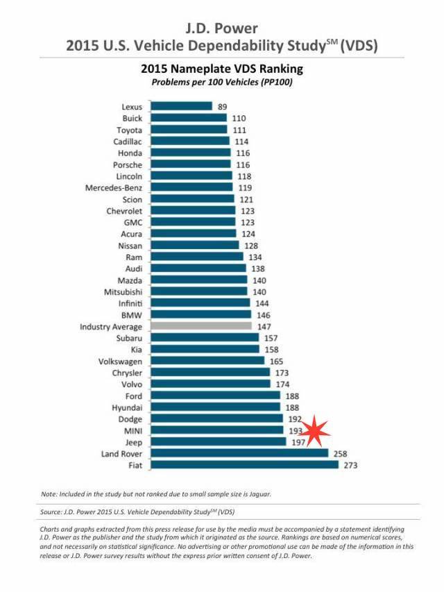

As with any car, you take your chances on a Fri. car. Mini's are high maintenance but if you take care of it, it will take care of you. Now, if you believe the surveys....
