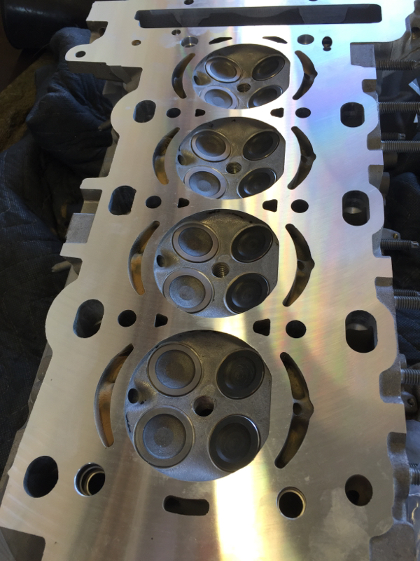

Just got burned by my MINI again. Carbon deposits are so bad that it threw a CEL.
Prescription:
- Rebuild head
- Remove, clean and polish the pistons
In three years, I have about $7K in repairs on a car with 77K miles. I only put 40K of those miles on it. If I had a crystal ball, I would have ran away at first sight.

Originally Posted by CmdZ
Just got burned by my MINI again. Carbon deposits are so bad that it threw a CEL. Prescription: - Rebuild head - Remove, clean and polish the pistons In three years, I have about $7K in repairs on a car with 77K miles. I only put 40K of those miles on it. If I had a crystal ball, I would have ran away at first sight.
Have you tried an oil catch can or some other from of pcv modification ? Also, not to add power but for cleaning every once in awhile, if you find some one with a methanol system it might be worth investigating. I just built a motor and im adding methanol injection. Not just for power cause if you run the car hard enough for that system to keep coming on it'll blow up most likely. Cant run things wide open. But reason number 2 is for intake valve cleaning. But not for cleaning after 40k miles. Maybe like 1 a month. Every other month. Or shoot it once every oil change. Idk. Just an idea. Maybe itll bring up some other peoples thoughts

I asked about an OCC, but my mechanic said it didn't really address the issue. I'm also a bit of a straight arrow when it comes to CARB/smog check stuff. That nixes the MIK as well.
My rebuilt head came back nice and shiny. Next is the piston heads. They're getting sent out for polishing.
