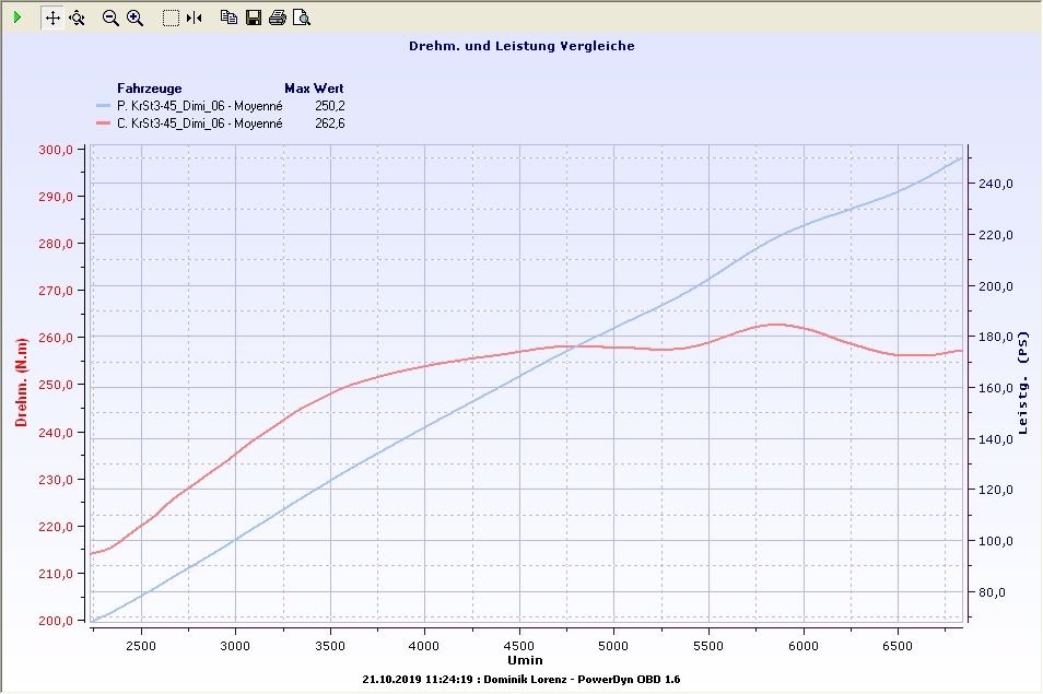

After long painful time, with complete overhaul of engine, are lots of parts also changed.
Engine ist engineered in Stage 3, by Dr. Krumm in near Colone. A really good mechanical tuner.

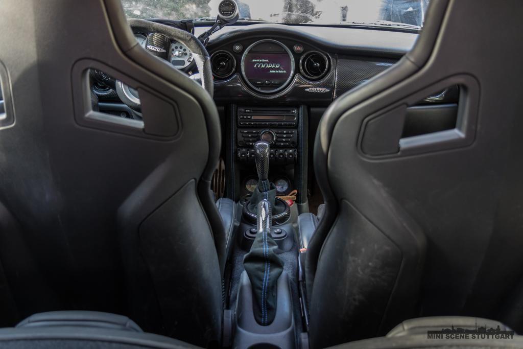

Love that steering wheel! Do you know where it was purchased?
Old Dec 8, 2019 | 08:25 AM
flyingart's Avatar
flyingart
Joined: Dec 2019
Posts: 25
Likes: 11
@cooper48
yes.
This is a forumlar origin 3-Spoke MFL Steeringwheel out of a Facelift R53.
Modified by:
https://meinlenkrad.de/
The are doing it as you like in an really top quality.

Nice, you have some rare Gen 1 MINI parts in it. Glad to see the old Euro Recaro seats. CF trim and dash. Euro cubby and the Gen2 JCW BBKs on the Gen 1. I have those also on my R52.

Love all the carbon fiber trims and that steering wheel. !!!!

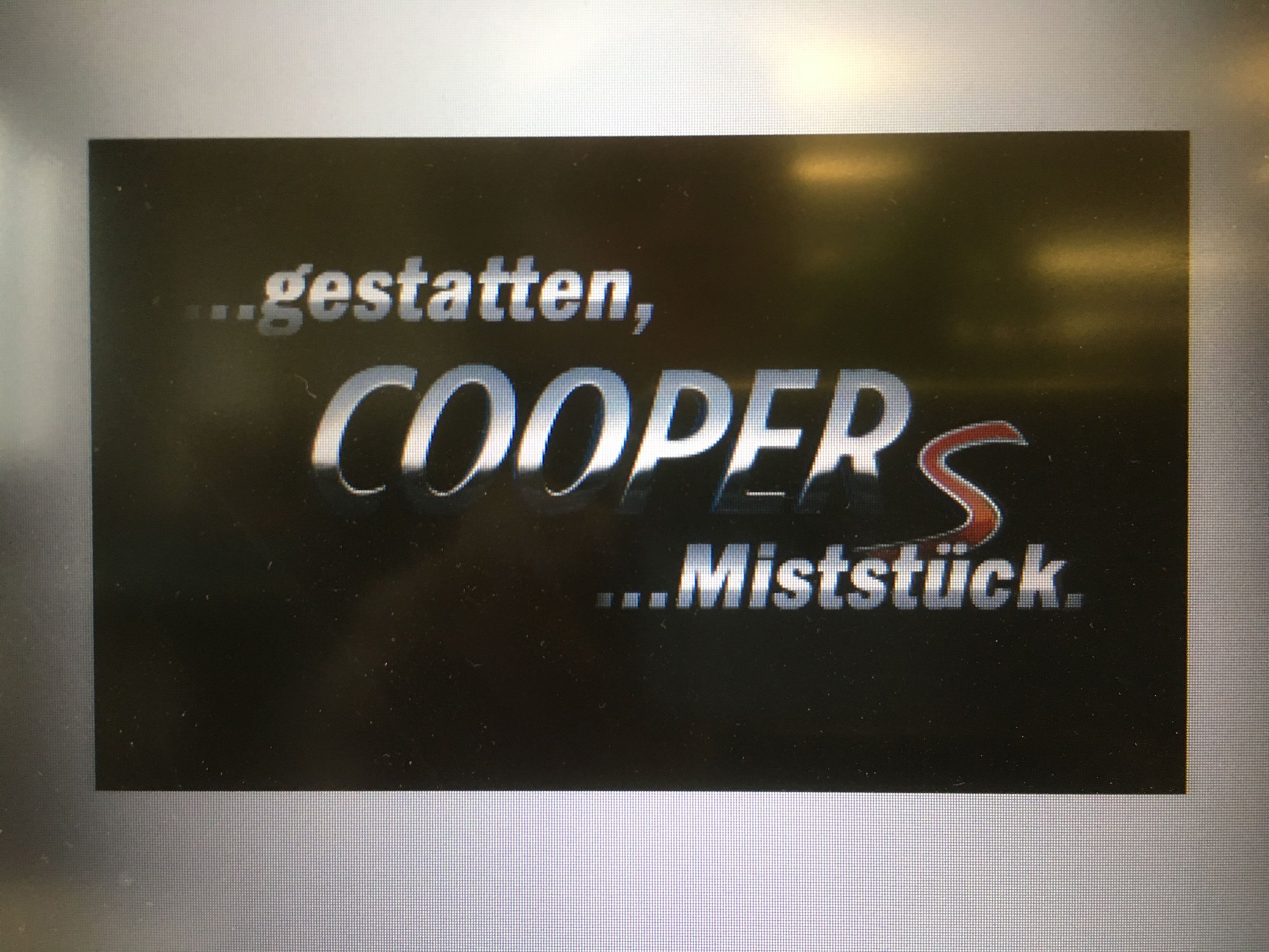

The custom screen was created by a guy in Germany. He designed the pic out of my wishes incl. shadows, and programmed it in Firmware.
A fulfill service. Send me a PM and I’ll ask him if I‘m allowed to share his contact.

Toolset for changing MK IV Startup Picture
Hi guy and gals, i'm the german guy metioned by flingart just berfore.
I would like to share the toolset and instructions with you for free. Because i got benefits from this site in the past. So this is a chance to give something back.
Unfortunately i've not enough time right know, to translate the step by step guide from german to english language. But perhaps somebody will do in the future.
This Step by Step instructions is a detailed guide on how to change your startup splash screen in MK IV navigational system.
Some fast suggestions:
This only works with MK IV Nav Systems. Used in Mini R53 and some BMW Cars. If you Cars needs the "High" Map DVDs. It's an MK IV. Others wont't work.
Picture Dimensions limited to 400 x 234 px on BMW Cars and 400 x 240 on Mini.
Picture must have GIF File Format with max 256 Colors, no transparency. You can use Photoshop or Gimp for example to make suitable picture files.
Picture must not have filesize over 50 kb. Just reduce Colors to 128 or 64 to reduce filesize if needed. I don't remember the max. value but it should be around 50-80 kb for the splash Logo.
MK IV Navi is very stable. So if you only get blank splash after installation. There is something wrong with your picture. Just give another try. Limit is only your amount on blank CD Media. Because you will have to burn another firmware CD for every change.
By the way: EVERY Picture in MK IV system can be replaced with this toolset.
