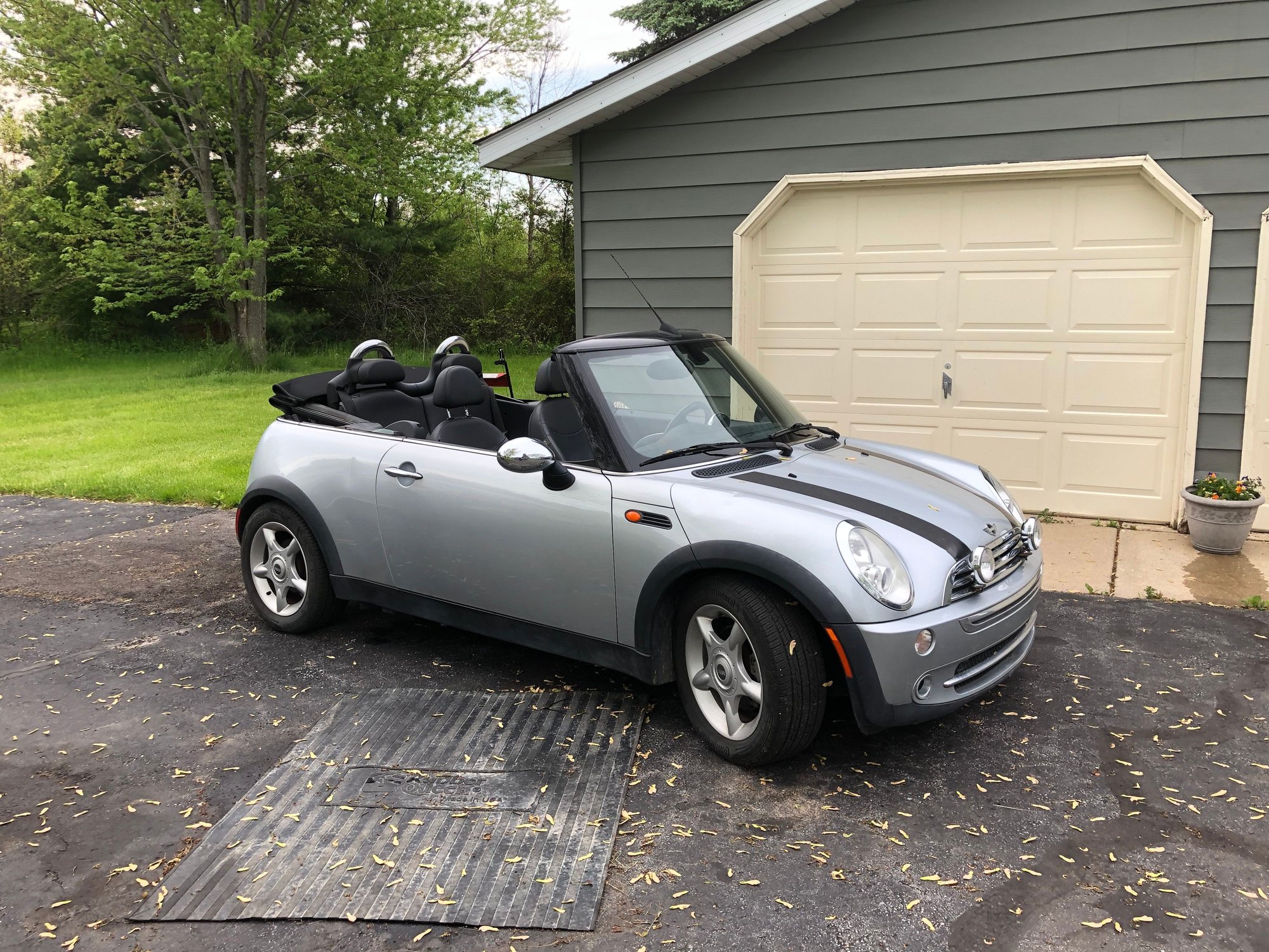

My name is Pat and I’m the proud new owner of an 05 R52 (base).
I paid $1400 for it with no 5th gear and an inoperable convertible top.

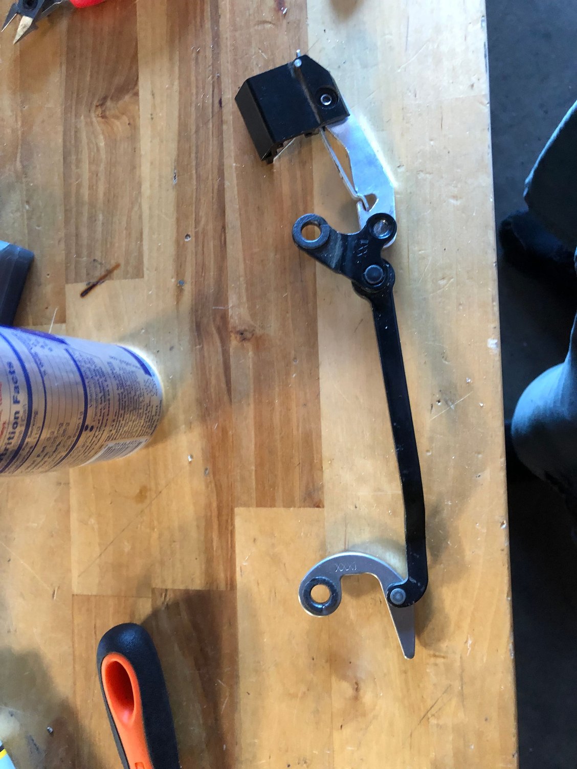

So, I fabricated a replacement for the cracked plastic link on both latches so that the cables could sense properly, and proceeded to familiarize myself with the Getrag 5 speeds. The pictures should tell you the rest.

Here you can see the link reinstalled as well as the parts transmission I picked up from a wrecked mini

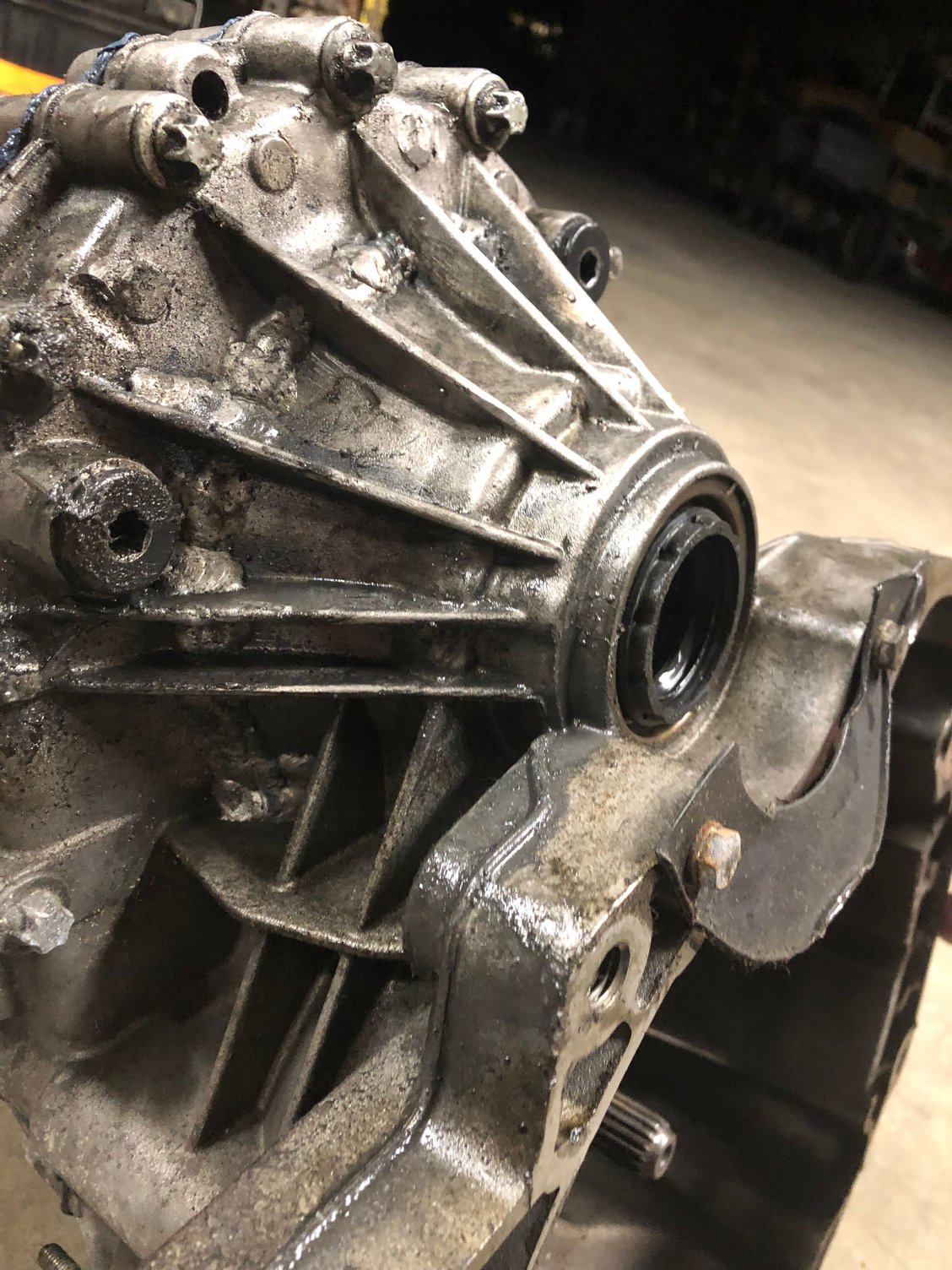

And here is the 2nd transmission I picked up, was making noise, but had good cases. I built one out of the two along with new synchros, bearings, and seals

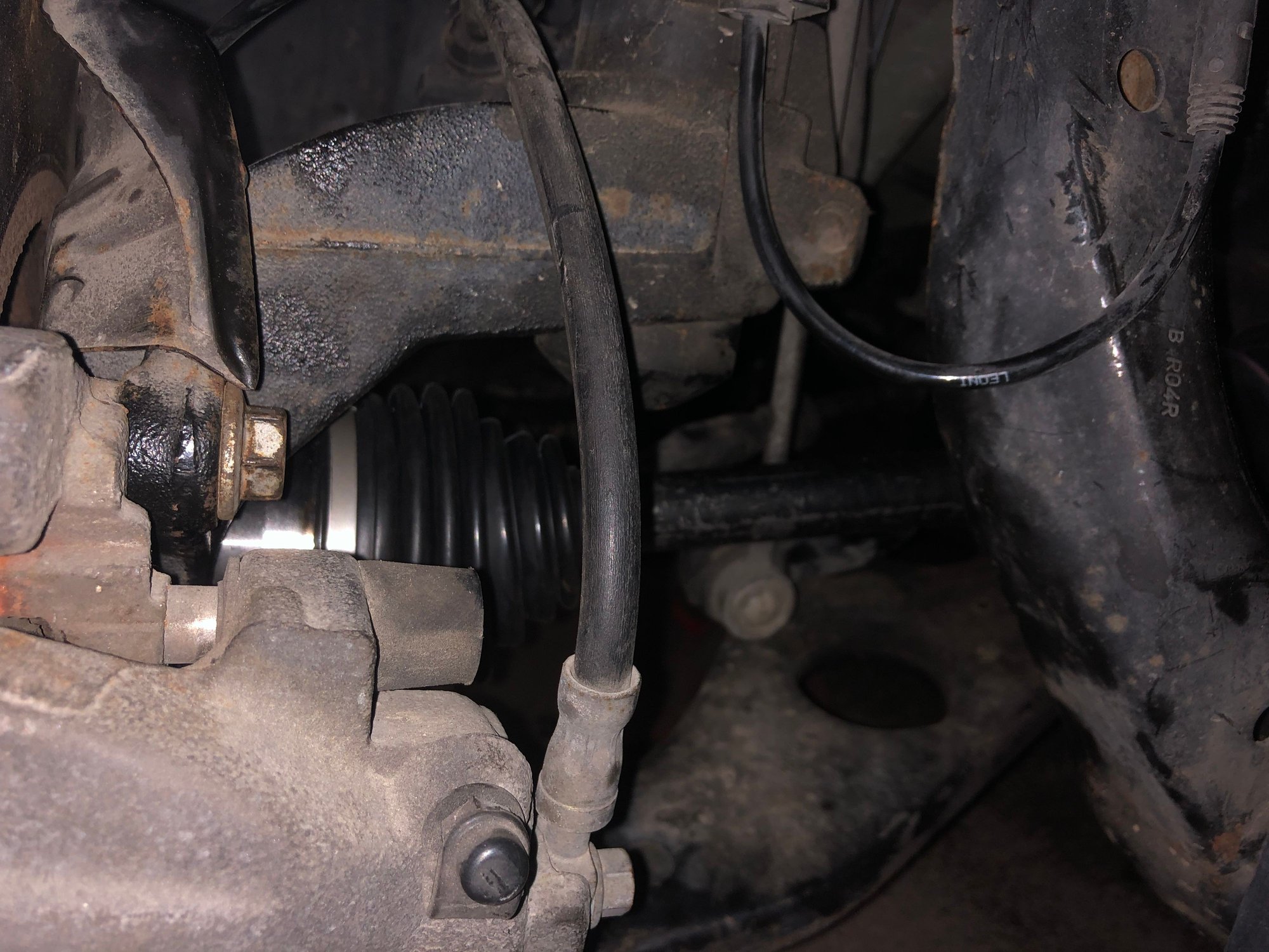

New outer ball joints and cv shafts since the old ones were wrecked by the idiot that “repaired” the old transmission. Nearest I can tell, the old trans had a carrier bearing let loose

Do you know why the cases blew out? That is a fairly bad break, so I am guessing something jammed in the gears and blew the case. So what did you find?

Well, the carrier bearing for the bell housing side that was “repaired” had been replaced along with the race, so I’d have to assume that that’s to blame. Especially since the carrier itself is beat up where it made contact with the case.
im sure debris from the failing 5th gear shift fork had something to do with it as well
