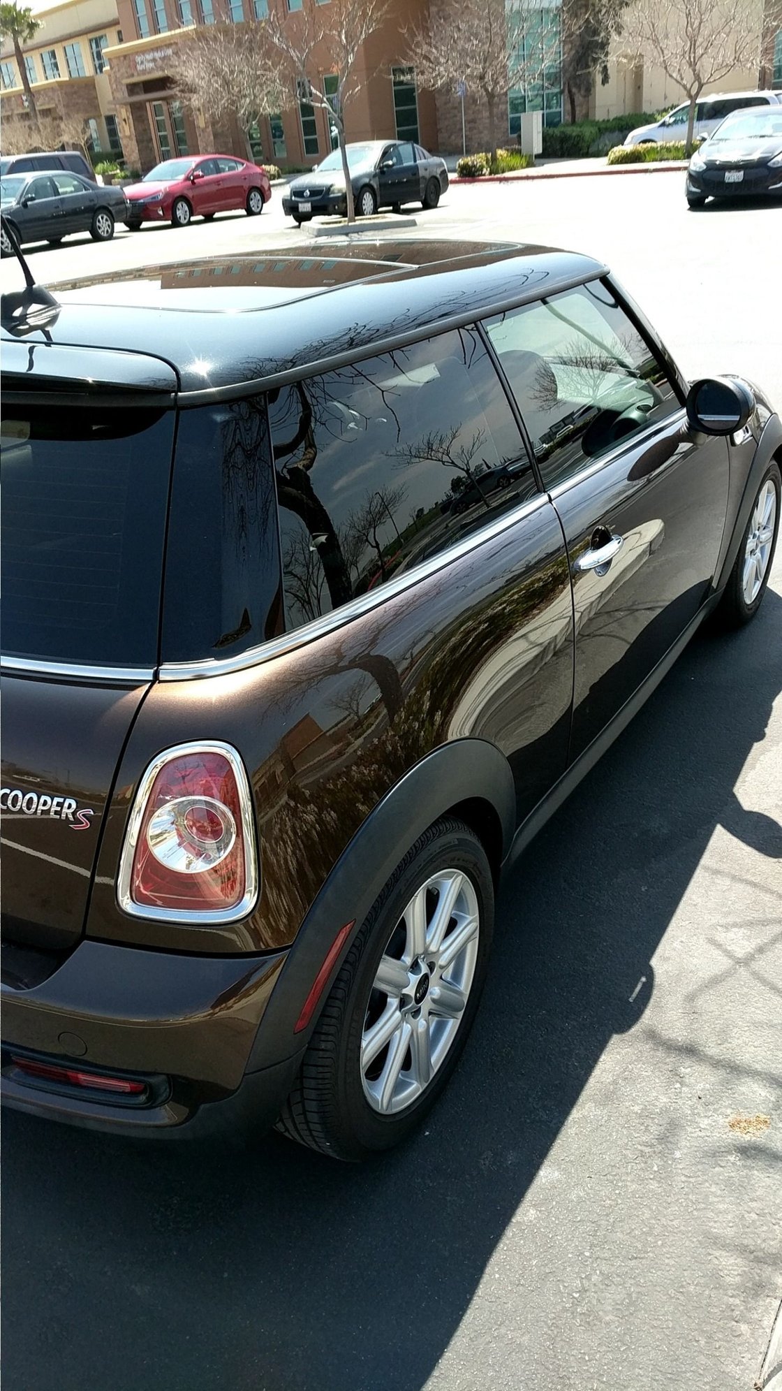

Hey guys! I've never owned a car and recently purchased a 2013 MCS and trying to figure out what any indicator lights mean is really new and confusing to me. If anyone could explain what these things showing up on my tachometer mean it'd be much appreciated!!

I don't get any warning lights. The pictures of the oil and brake information is the information you get when you toggle through the service info settlings on the tachometer screen. I am getting the lift symbol with the date 3/2019 when I start the car but then it goes away while driving. I don't have any other lights or symbols while driving. I am under the impression that negative numbers such as -800mls would mean service is due but mine aren't in the negative. I just want to know what the lift symbol with a date means because I can't find information on that anywhere.

The light is showing the need for servicing. (the one with the car on lift) The oil is over due, or was not reset when new oil was installed. Make sure to use 100% synthetic oil and change filter every time you change oil!
Check brake fluid.
Coolant
As already stated. Mini is a car that needs weekly fluid checks and regular maintenance. Super fun has it's costs! Hopefully you will learn to do many yourself!
