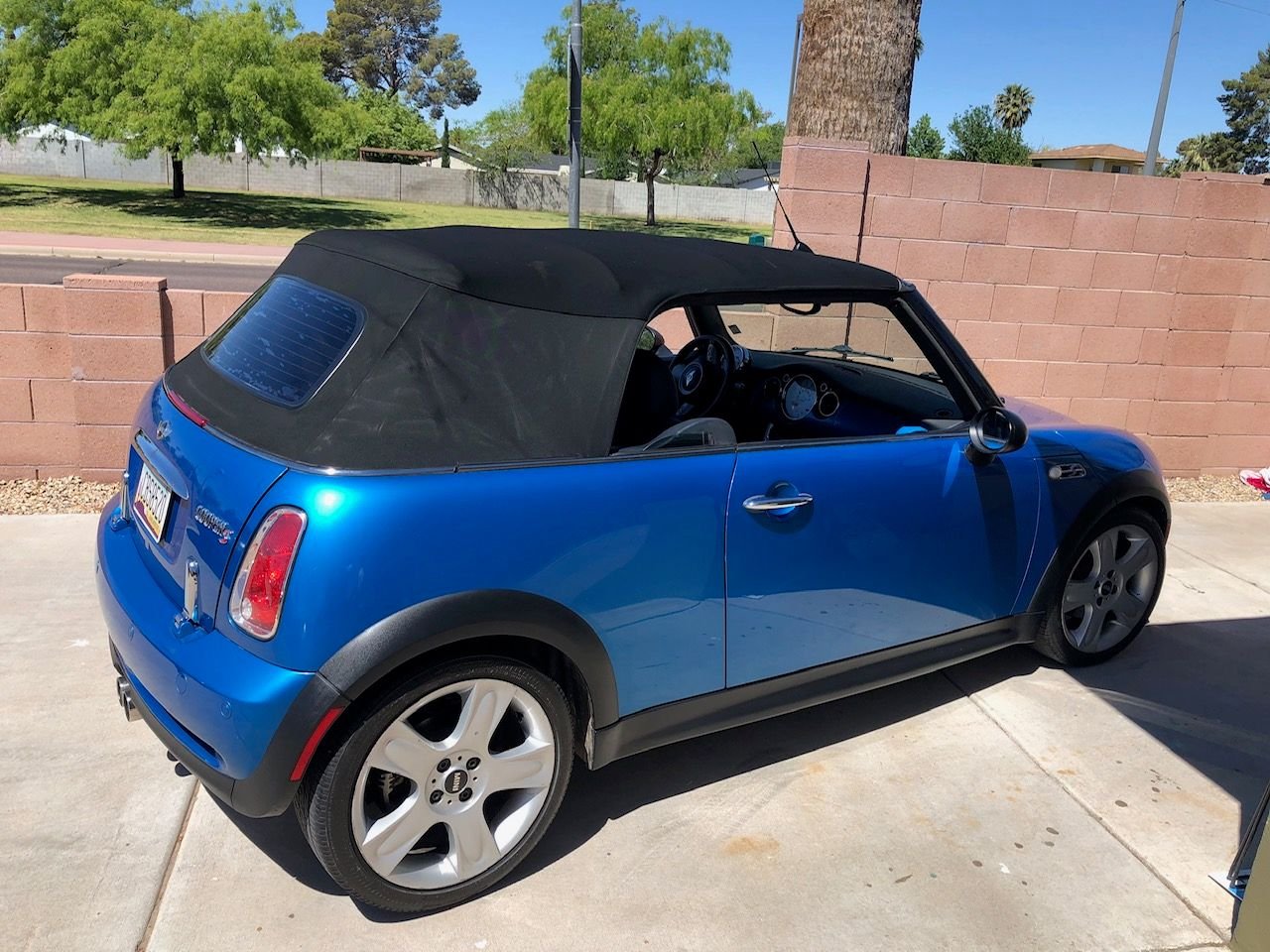

Greetings MIni fans...I am very pleased to be joining you. I have always wanted a mini and today I bought this beautiful blue with black top 2007 Mini Cooper "S" 6 speed with 85k miles on it. I really enjoyed driving for the first time this afternoon...it is fun, quick, and handles like a dream.

Welcome to the 'proper' mode of MINI motoring. After all, topless motoring is motoring at it's best.

I do notice a striking irregularity that must be corrected. That is, the sun is obviously shining and that big ugly black thingie is covering up most of the vehicle.
Only 3 reasons my top goes up. It's raining or snowing, my co-pilot is whinging louder than the SC about being too hot or cold and I can't hear it or some drunks are throwing empty beer cans in the back seat and didn't invite me.
