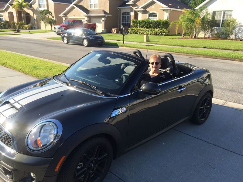

Spousal unit recently bought an R59 - the Roadster ... a 2015 orphan on the lot that we got for WAY off sticker. It hasn't been back to the dealer yet ....

Love the roadster, going to have to get me one of them someday.
