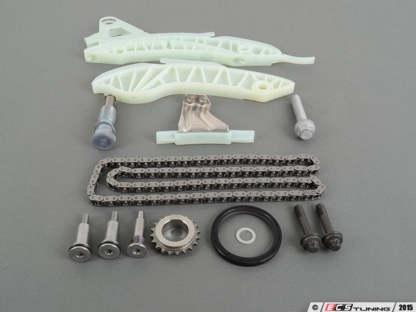

+1 on do the timing chain and check for bent valve. If you an pull in the intake manifold off and shine a light down the side of the head into the chamber you might get better view of those valves. make sure you get the right full timing chain set with the correct updated tensioner. Our full kits come with it. ~551 version.
https://www.ecstuning.com/Mini-2007-Cooper-R56-Base-Coupe-L4_1.6L_N12B16A/Engine/Timing/

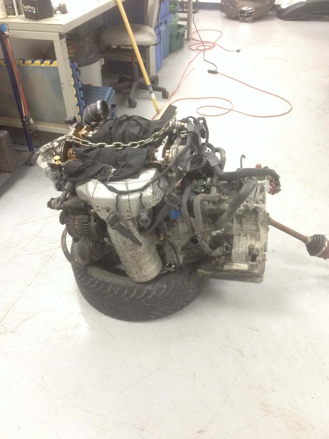

So ... I thought I would post an update to my "little project" ... my plans to do a quick timing chain swap and run with a steal of a deal went south after finding out a LOT of valves were damaged in the original head ... move on to "plan B"
I decided to pull the bad motor and look for a complete drop in ...
It was not a "horrible" job more a pain in the *** :/
The donor is a 2008 6 speed with a 100000 kms that was still running perfectly after its owner decided to park her in a guard rail during a rain storm
The 2nd engine removal starts this weekend
I also picked up a set of Eibach lowering coils and a set of tires and wheels to keep this project on track ... I thought about doing a complete 6 speed swap as well but my wife wants to keep the automatic so ... auto is
