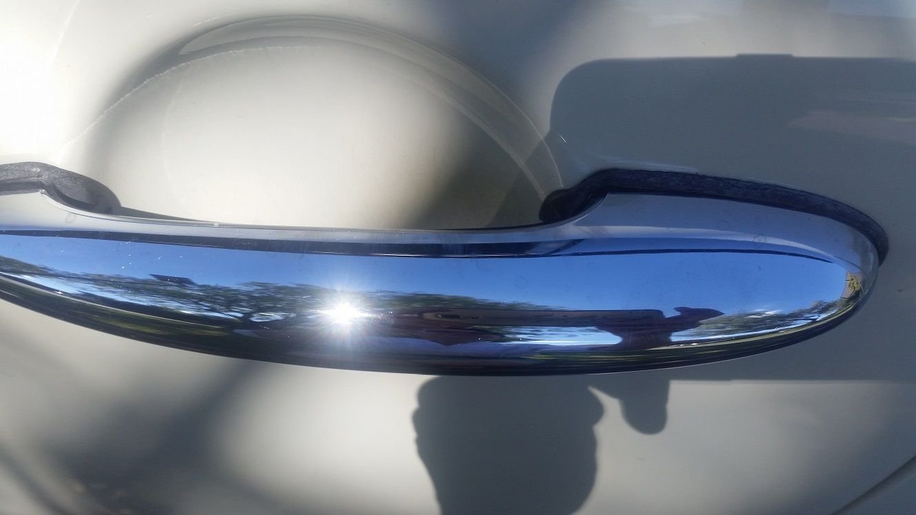

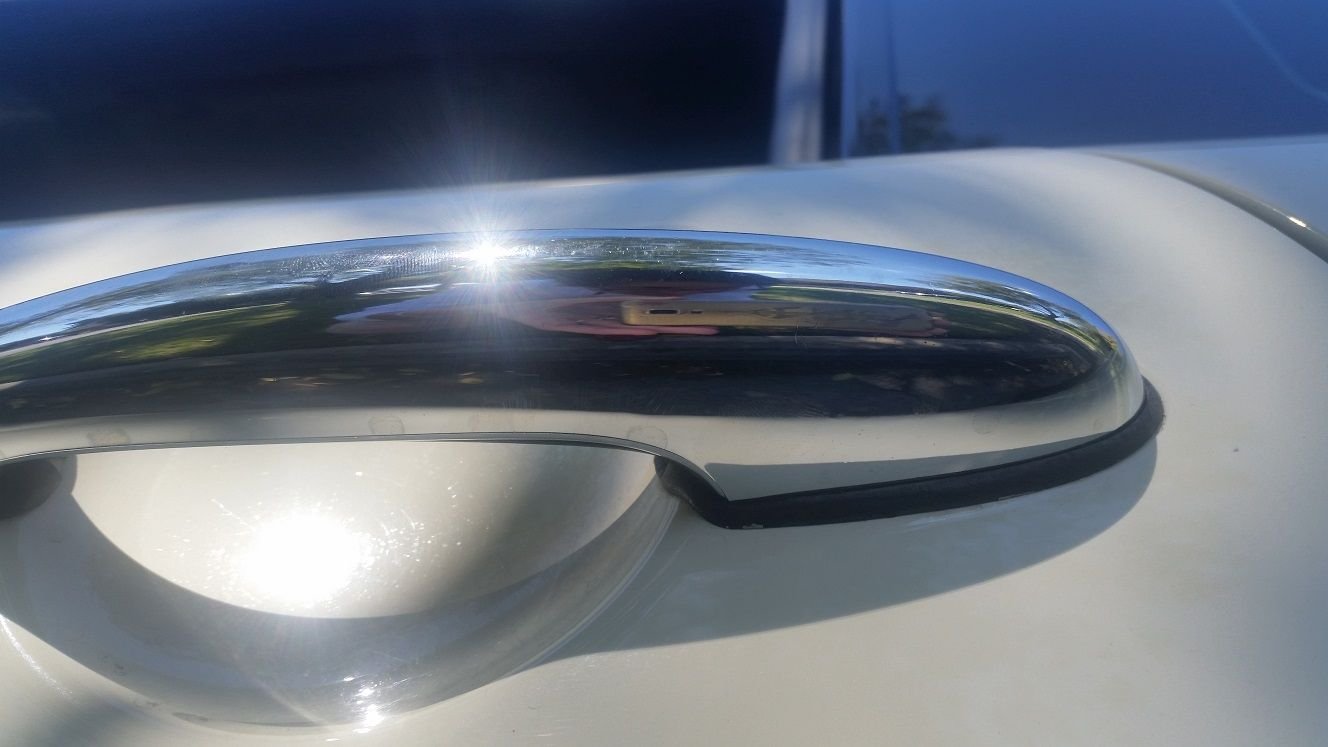

As a sanity check, examine the handle closely and make sure that it isn't just a decorative cover attached over the standard door handle. Compare it to the one on the passenger side.
Old Sep 17, 2015 | 02:00 PM
MiniUnz's Avatar
MiniUnz
Joined: Sep 2015
Posts: 21
From: Lodi, CA
*headdesk*
*gets another dollar for checking for the umpteenth time*
here are closeups... no cover. I WISH there were one!
top side of drivers side door handle
underside of drivers side handle
straight on, drivers side door handle<br/><br/>
Old Sep 21, 2015 | 08:54 AM
Posts: 36,762
Likes: 2,551
Yea, I bet the owner ordered like UK handle for the driver side for a clean look. Which is the same as the US passenger side just flipped. I remember people asking to do this back in 05'
