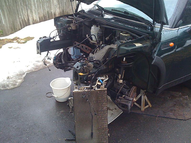

Since driving my friend's 02 M50 out in California on vacation, the MINI Cooper has been on my short list of cars to replace my Jetta TDI as a daily driver. Nothing wrong with that car, but after 180,000 miles, and some life changes, I felt the desire for a something different, and less pedestrian. When I saw a BRG 2002 with 121,000 miles and a blown trans on Craigslist for $1,500, I had to check it out. I was going to look at another car that day, and had the cash on hand, so I bought it on the spot. It was a lovingly cared for, one owner car that found it's way into the hands of the owners son for the past six months. New, young driver plus Midlands box equals shrapnel.
The next day, I brought the car home on a borrowed trailer, and set it in the driveway. The day after that (New Years Eve), I got it up on jacks, stripped the modular subframe, and pondered a drivetrain extraction, or dropping the subframe and pulling the trans by itself. I only had a few hours that day to work because of a New Years Party I was hosting. New Years Day, the engine and trans came out as a unit. The Bently manual I had ordered obviously had not arrived yet, and with what I could gather from the internet, and my own observations, it was 6 one, half dozen the other. At least this way I'd be spending almost no time on my back.
It wasn't a particularly difficult job, but the fact that I needed to remove either the engine, or the subframe to get the trans out, made me wish to do it once, and do it right. So I'm going for the Getrag 6 speed conversion. I bought a 2005 R53 box WITH LSD and 50,000 miles for $1,300 shipped. While this will be a commuter, I figured the LSD will be a plus in the snow (car also has DSC). I obviously have a lot more stuff to buy (including tires), but I'm feeling pretty good about what I have for the money. I'm thinking I'll be on the road for about $4k. My TDI is worth more than that on a bad day, so I'm even going to be ahead there. Granted this car will likely give me a lot more headaches than the one it replaces, but the TDI was reliable to the point of being boring.
Pics of the $1,500 MINI Cooper:

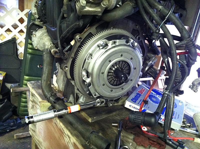

Oh, THAT project, haha. Geez, I've got my finger in too many pies right now. This one kind of sat all winter, as I've been pretty busy. I did take a half day to get the new flywheel / clutch setup installed, and fit up the transmission. As the engine was out of the car, I had the luxury of doing this on the workbench, as opposed to on my back, which made pulling the entire shebang worthwhile to me. If I had the luxury of a lift, then dropping the K-member might be a better route.
In any case, I went with the Exedy single mass conversion, which wound up being a couple of pounds heavier than the stock R50 flywheel, but better than the 12 or so pounds heavier that the Valeo would have been. Yes, I'd feel more comfortable with a Valeo clutch in there, but this will be just an A to B commuter, so I should be fine. And the price was dirt cheap.
The only thing keeping me from getting the thing on the road at this point (besides a free weekend) is the Bowden cable bracket, and some new output shaft seals. Other than that, I've got everything I need in waiting.

Wow, I didn't realize just how tight my schedule was until I tried to do button up this conversion. I got a half day on Saturday to play with, so I dropped the drivetrain back in the car. Simply connect a few pipes, wires and hoses, and it's off and running, right? Wrong! I ran into an issue with the shifter cables that is perplexing. The cables are simply too short. I'm using the stock cables and lug (as installed), and Bowden bracket 23-11-7-509-737 (supplied by dealer). According to the Bentley manual, I see no provision for adjustment. And I'm not wanting to drop the exhaust to check unless I need to. So either the bracket, the cables, or my information is wrong. Since the cables are original to the car, and all information points to them being identical to the Cooper S parts, I'm wondering if there might be more than one Bowden cable bracket that would look right for this application. The angles are good (as opposed to the one from the Midlands). Could I have the wrong part here? Any suggestions? This kind of sucks, because the car is ready to rock, except that I can only get two gears (3rd and 5th, I think).
Nevermind. A search here showed several people confirming that I do need "S" shifter cables, which makes sense. I don't know why two suppliers I checked listed the parts the same for both cars. Maybe I was looking at later getrag equipped Coopers, not Midlands. Anyhow, it's off to grab the angle grinder, and get those exhaust bolts cut off.
It's done, car is on the road, and drives great! I wouldn't do this swap pre-emptively to replace a functioning Midlands, but if you need to replace the transmission anyway, it's no tougher than a stock swap (assuming you will change clutch in the process). Ok, dropping the exhaust to change out the shifter cables isn't my idea of fun, but that was really the only extra thing I can think of, besides the reverse light, which is no biggie.
