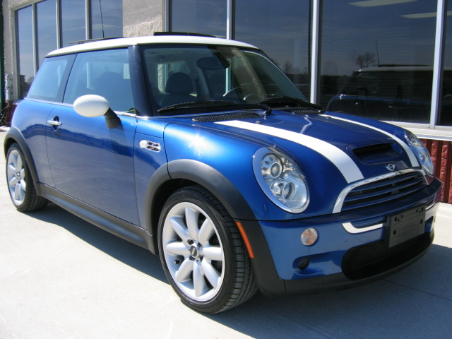

I want to help, not be a bummer, but, to me it looks like the rear is a different color than the front. If you have polarized sunglasses, it is often even easier to see paintwork and just because it was painted, doesn't mean it was wrecked, or that it wasn't fixed properly.
If you open all doors, often you can see a tape mark where the car was masked off. No one ever bothers to sand the slight height difference in the paint off in the door, trunk and hood jams. It may just be the photos also, but ask if the car was ever painted or wrecked and have them answer in writing on the bill of sale. Lookin under the car and carpet will give clues often too.
I hope it works out well for you and remember, I am not saying paintwork is always bad. It is only bad if you don't know what you are buying, or buying one thing and getting another. A painted car should be cheaper and can often be a great value. One just wants to avoid paying top dollar for damaged goods.
This photo is the one made me think. Door looks painted (or front/back of car) Remember, if it is just the door, it could have been a scratch they fixed and it was never wrecked, if the front and back look totally different, the odds are it was a good collision that prompted the work.

I see what HRM is saying, check that out.. But honestly if it has been repainted. It is not that noticeable and for that price, who cares! good luck!

Thanks so much for all the responses. I went to the dealership today, and inspected/drove the mini. I asked them about the paint, and they said "no paint work", so I said I thought the passenger door/rear quarter looked "off", and they actually took a paint meter to each panel. It's a device that measures the thickness of the paint, and all the panels were close in range.
It seems to be in great condition. I couldn't find a dent, or even a scratch of significance. I've looked at a lot of Mini's, and this one seems to be in immaculate condition. The driver's side window was a little jerky the 1st time I put it up, but it was fine the 2nd time. The interior was in perfect condition.

Glad to hear Hammer. If the car didn't look painted up close, you are good to go. That photo makes it look like you should see a difference 20 feet away, so it is obviously just an illusion.
