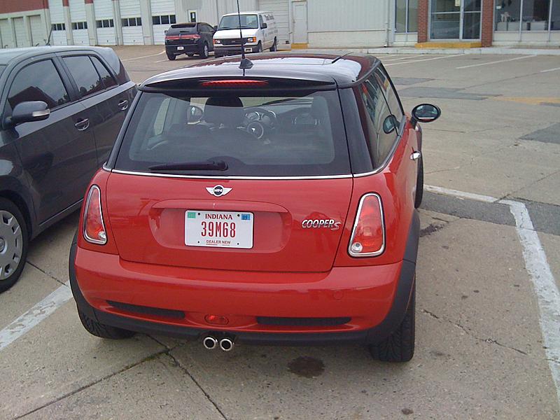

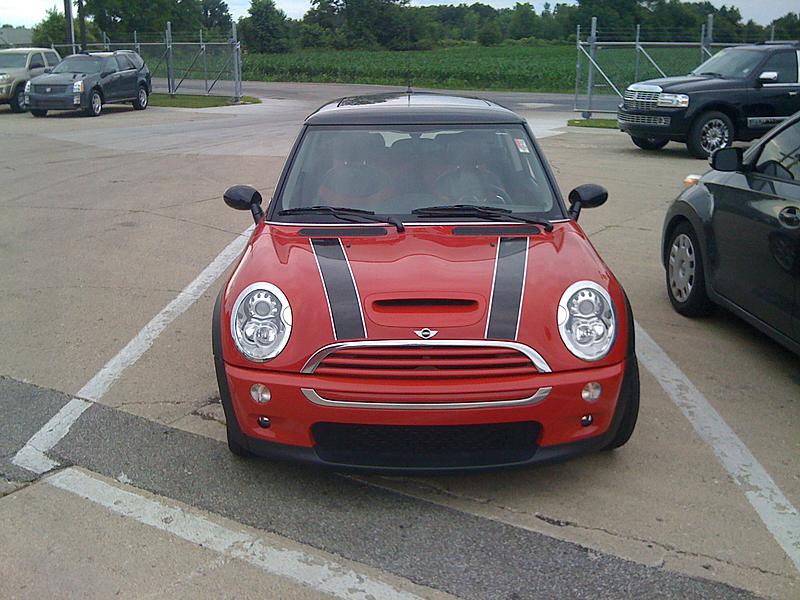

I've been wanting a Mini for awhile, looked at several used S models over the last several months and now I think I'm ready to buy. I've searched on here a lot for information and other things.
The car I have narrowed it down to is a 2005 S hardtop with 30k, red, I've attached photos of it at the dealer after my test drive.
What wheels are these, I usually see the big spoked wheels vs. these.
It drives fine, rather rattly and you feel every bump, I'm assuming this is the way they are. At 30k, suspension should be fine. Should the brakes/rotors be good for awhile?
Clutch, tranny?
Are there any things to look for when buying a used Mini S? It's a 1-owner car.
I just want to see if there are any issues from that year/era that I should look for before I decide what I want to do.
I'm trading in my 2009 Scion xD on it and seem to be getting a good deal. A difference of $850 plus tax for the Mini.
Thanks.

Those are OEM wheels.
http://www2.partstrain.com/store/det...Y59529U10.html
Replacements can be found there.

Those are OEM wheels and are a 2 piece wheel and make sure you insure them because they cost more then most to fix or replace.
Check the build date on the drivers door jam since some 05's were built in 04 and there are some minor differences.
With 30K the brakes could have 15K +/- left on them.
There's not too many things that should be wrong as long as it was taken care of by the 1st owner.

wheels are flame spoke probably has run flats. ditch um, rides harsh,ware out fast, expensive to replace tire dealers hate em !

Don't forget to check for rust under the weatherstripping along the door sills. There's a long sticky thread on the issue. If you find it, the dealer should make the repairs before you buy the car.

Sorry but those are not flame spokes,, those are R98 web spokes.
If you look closely at the tire and see a circle with RSC inside the circle, then they are run-flats.
