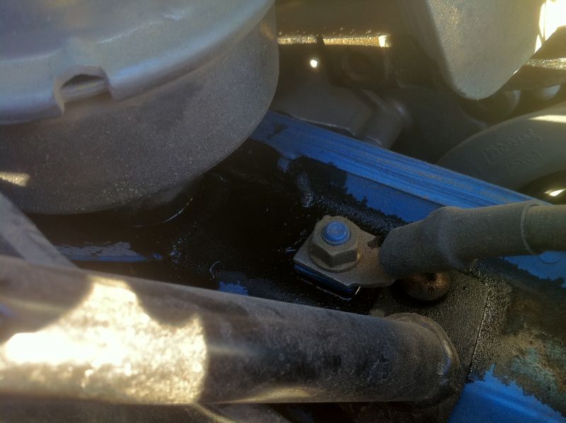

i got the oil changed in my mini about a month ago and didn't have a problem until last night or early this morning. there was a spot underneath the car, but it was right next to the passenger tire in the front of the car. i opened the hood and saw oil on the frame. i wasn't sure where it might be coming from, so i thought i'd ask here. any suggestions?
the first image is a further back shot while the second is a close up of the oil.

It's the hydraulic engine mount......you must have an 05/06 model....convertible ?

yes, i'm sorry. i left some details out. it's a 2007 mini cooper s convertible. so, the mount is leaking. are there gaskets in there that can be replaced?

No, the whole mount has to be repalced. It's the can looking thing above the leak. They run from $90-135.00 ea.
Part no. 3 here: MINI PART NO. 22116778610
You will soon notice a clanking sound from behind the glove box when engine moves while driving.
It's the engine mount moving beyond normal limits. Ok to drive it for a bit until you get it replaced....

If you've still got factory warranty left, it will certainly be covered. I haven't heard of MINI replacing them out-of-warranty as a goodwill gesture, though.
The leaking motor mounts are par for the course. We had to replace that part in both of our 2006 'S' convertibles. The good news is that MINI redesigned the part at some point, and the replacements seem to last longer than the originals. I know tons of people that have had to replace the mount once, but only one or two that have had to replace it twice.

BTW Zaerion, use some brake cleaner or engine degreaser on that mess so it doesn't damage the paint there. Careful not to get it on the belt. And if your are under 50K and the 4 yr mark, have the dealer clean up what's left before replacing the part !
Some have been sent home w/o that being done.
