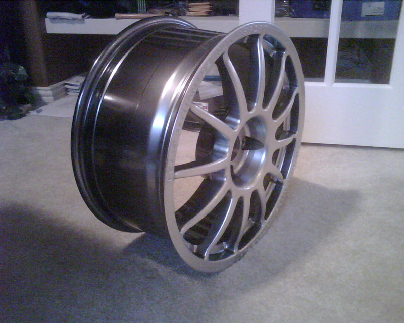

Just picked these up from Webb Motorsports.
Team Dynamics Pro Race 1.2, 17x8, 38mm offset, Hi-Power Silver
Just waiting on the 235/40/17 Bridgestone RE-01R's.
No spacers, no nothing. They fit as is!

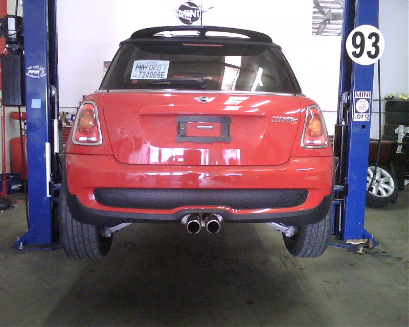

This is a great picture of the 17x8 (with 235 RA-1's) vs stock:

235/40/17's with stock set up did fine on the autocross course. No dectectable rubbing or problem.
The lowered R56 (h&r springs) rubs just slightly on the outer edge of the tire against the fender liner both front and rear upon compression when racing/driving. Nothing significant enough to cause problem or issue. Just a little plastic on the underside of the fender is gently removed by the tire. As the car is lowered more negative camber is available. Roughly 1.5 degrees in the front.
