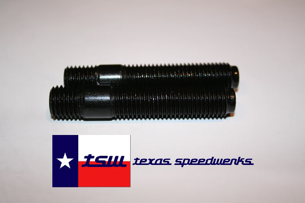

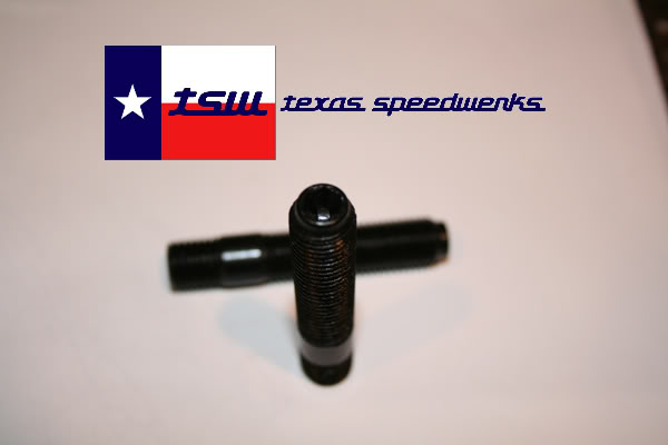

Hi folks,
We've had a few people contact us, concerned that they see a bit of surface rust on the conversion studs. The studs are protected with a black oxide coating, but it is true that some discoloration can become evident on the threads with use.
I want to assure you that this "blushing" does not in any way compromise the strength of the studs. If the discoloration is bothersome, a wire brush and a light oil will knock it right off. A very light application of Permatex anti-seize to the threads of the stud will also greatly diminish or eliminate oxidation.
I have driven, and raced, on oxide-coated studs for about 20 years now, and my father used them exclusively for about 25 years before that, so I am quite sure they will function well.
