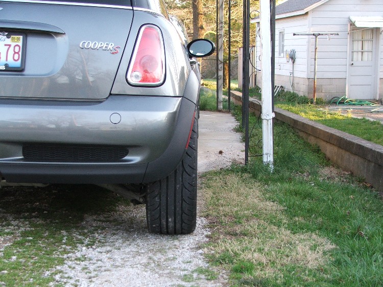

I'm running a 16x7 combo with 225/45 Hankook RS-2s and stock height, and only get rubbing on rally-like dips and bumps. The wheels are ET+38 MB Motorsports from Discount Tire, AKA A-Tech wheels with a different center cap. I realize this isn't a 15", but you shouldn't be too far off from these numbers.
Have some pics!
Attached Thumbnails What offset works with 225's on a 15" rim?-wheel-width.jpg   What offset works with 225's on a 15" rim?-side-1.jpg
