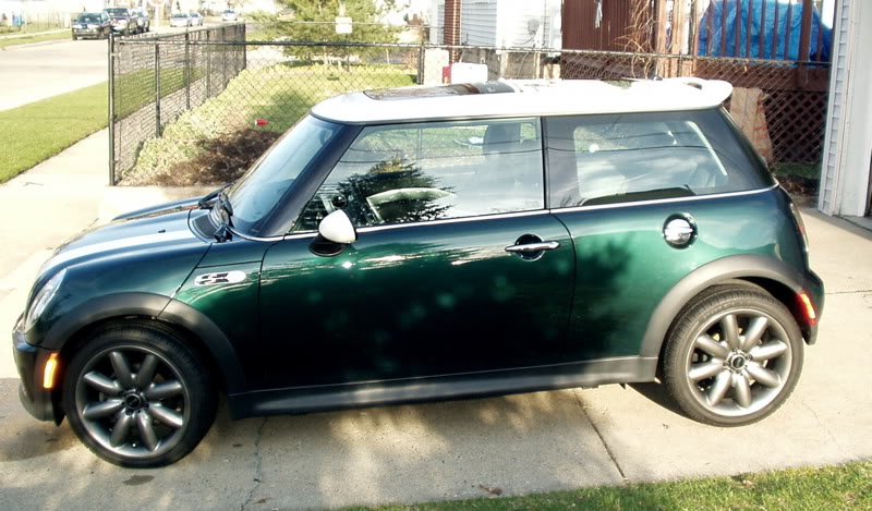

Here you go - just did this two weekends ago. They need another coat (the spoke edges are tricky). I've always had good luck with the "graphite" color and NO clear coat. Clear coat always manages to mess up the finish and even in pebble-strewn Michigan, I don't have much problem with chipping.

Thanks guys, it's really a super bang for the buck deal (cheap too ) The paint that I used is Dupli-Color High Performance Wheel Coating - WP102 Graphite. The black sandable primer works great. I wrote up some notes a while back here:
https://www.northamericanmotoring.co...ainting+wheels
But there is no secret... well, clean, cleaner, cleanest. You just can't get enough dust off the wheels, 'cause you're sure going to see it after the primer goes on!
This last time I didn't even mask the tires with newspaper and it worked out great. Those metal spray shields are a must, but they can be made of anything that will grip the edge of the wheel.
Take your time and good luck!
