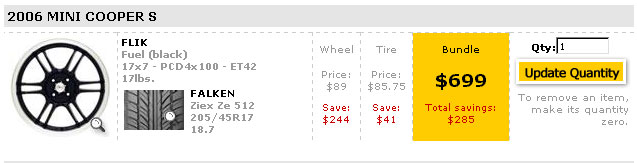

I ran accross this on a site the other day and wanted to get everyones opinion. I have the infamous S heavies and wanted to get something better but, not break the bank. Just wondering if the wheel manu. is any good.
Thanks!

Looks like a deal...
Get metal hubcentric rings for mounting them up.

From what I hear and what I've seen, they are pretty good as far as quality. Edge Racing also should warranty them, so you should be covered that way

Thanks for all of the input guys. Now, the big question - will they look good on an '06 HyperBlue/Black S?
