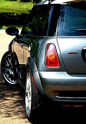

JUst remember the ASA AR1 are licensed through BBS....= High Quality

I got the ASA AR1 wheels (silver) today from the TR and they look great on my PW/B MCS. Based on Alex's advise I had him add the Yok es100 in 215 45 17. The tires are too new to comment on yet, but better than the 17 A/S runflats!
