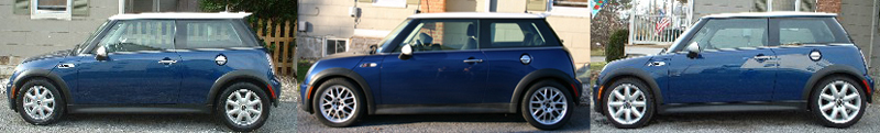

Originally Posted by bodinski
Get some light 15s. You'll be amazed at the improvements in acceleration and braking!
True. I really liked the look of the (somewhat misnamed) S-Lites, but found the ride a too harsh. I bought some 15s but didn't really like the look (a different wheel perhaps....) but in the end found a good combination that works for me. Now I use 15 inch R82s with Falken all-season 195/60s in the winter and 16 inch R90s with Goodyear GS-D3 summer tires the rest of the year. You can read about my experiences here.
The photo below shows the different look of the 3. Ditch your runflats regardless and you'll notice an instant imrovement in ride quality.
That's my .02....
Attached Thumbnails 15 16 or 17?? pros-cons....and tire suggestions-newr90s_400.jpg   15 16 or 17?? pros-cons....and tire suggestions-wheelcomparo.jpg
