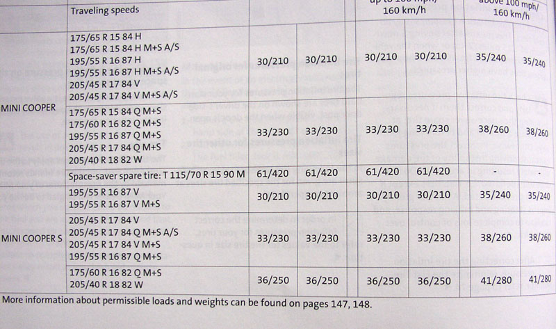

OK I see what you're saying now. The manual is actually contradicting itself.
The door jam doesn't say it's the max load. One page of the manual says the jam will have the correct pressure for the stock tires, while another page shows a generic chart, with varied pressures by load.
Either way, I like the stiffer ride in general.
